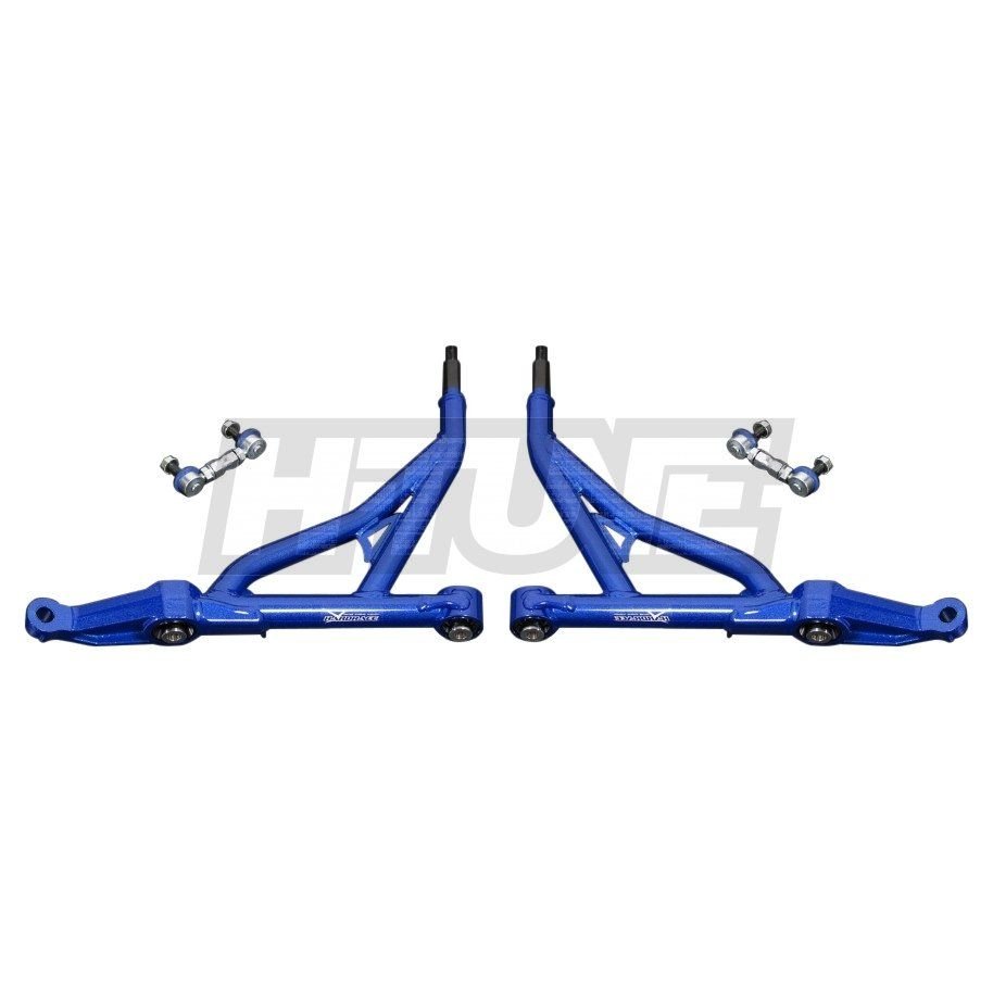

Here's what I bought and what they're supposed to look like hooked up:

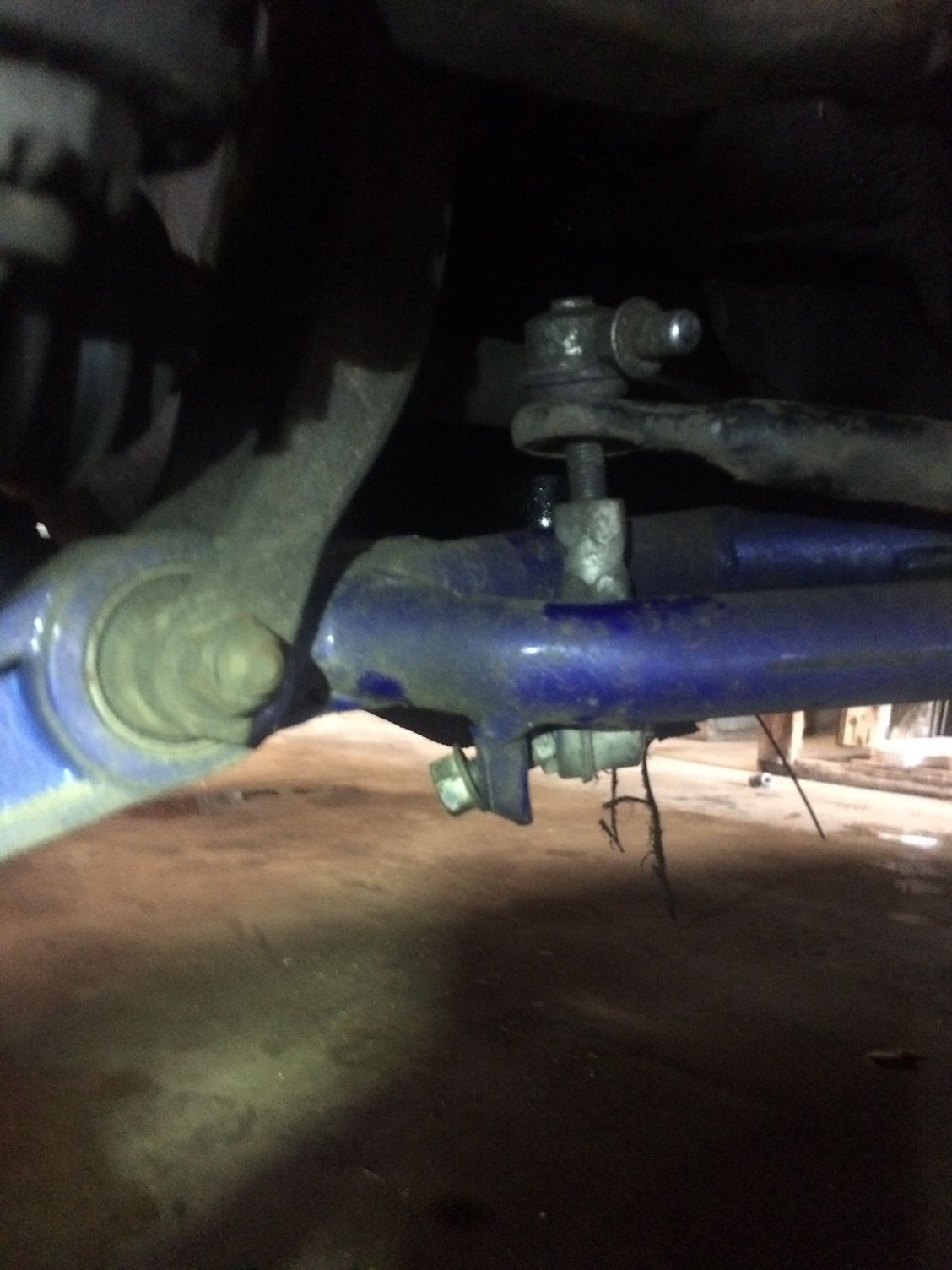

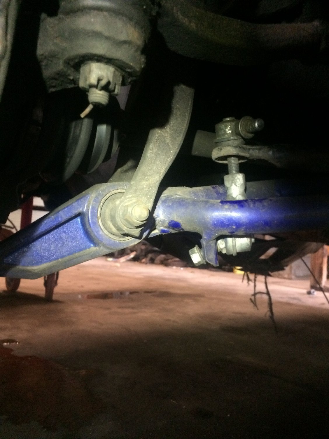

Here's an example of how i was going to hook them up and i know it's wrong and something is different.
I think i need totally different sway bars.

I looked at an old email from Hardrace and must have missed this part:
"When you purchase, advise the sway bar you are using. If you are using standard EG sway bar, you will need to use DC2R Front Endlinks.
If you are using DC2R front sway bar, you will need to use the silver supplied Endlinks."
http://www.buyhardrace.com/product/hardrace-front-sway-bar-end-links-94-01-integra-gsr-type-r_27.html
cant find that part though
Is this it? Says integra only unless i got a type r or grs sway bar

If you really cannot buy those or anything like it, then you would need to replace the bar with the other kind that has the attachment holes horizontal instead of vertical, which matches the links you have.
