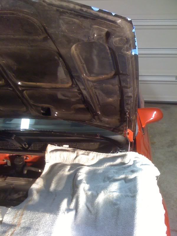

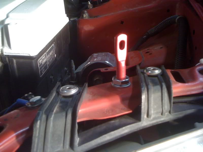

I first started by placing the pin in the hole between the headlight brackets:

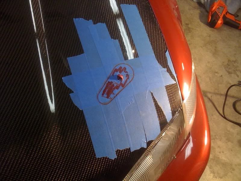

Next I put some toothpaste on top of the pin and close the hood so I could get an idea of where to drill the hole.

I recommend putting a towel down so you don't get all the fiberglass and dust everywhere.

Next tape the top of the hood to prevent cracking.

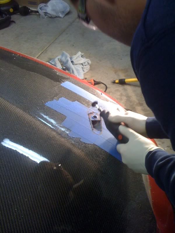

Here is the scariest part...go slow!!! Start cutting with the dremel!
