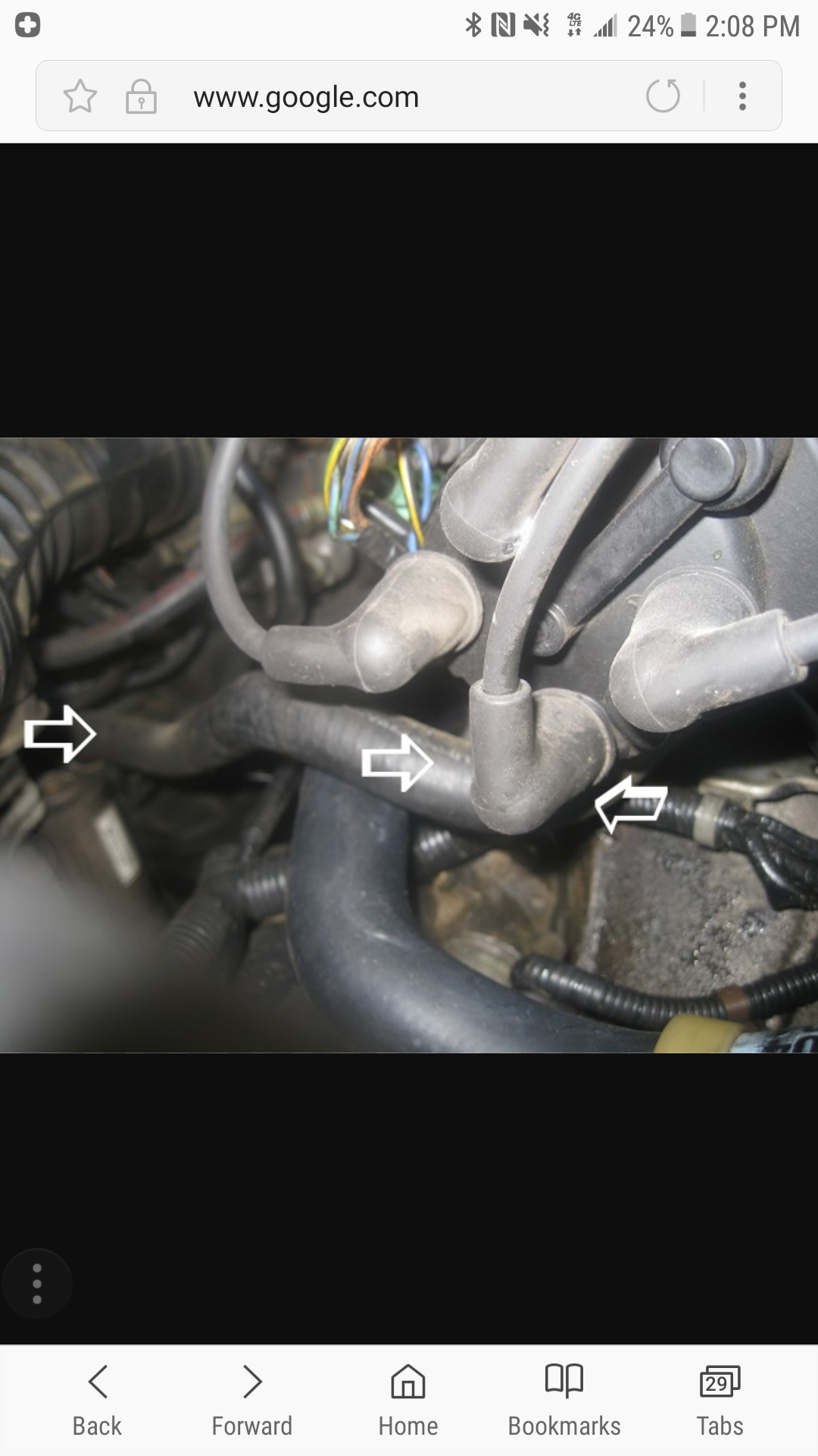

Probably this one. It cracks right after the clamp all the time. Just replace it and top off your radiator.

Originally Posted by egsleepercivic
take a pic dude
or find it on the parts diagram at one of the oem honda sites
hondapartsunlimited.com is one
another one
Majestic Honda - The Internet's #1 Honda Automotive Parts Store
Best pic i could find ill take a picture once im home

Check for oil residue under the distributor and hose that just ruptured. I can kinda see oil sludge on top of the transmission in that picture but you would have to confirm this.
