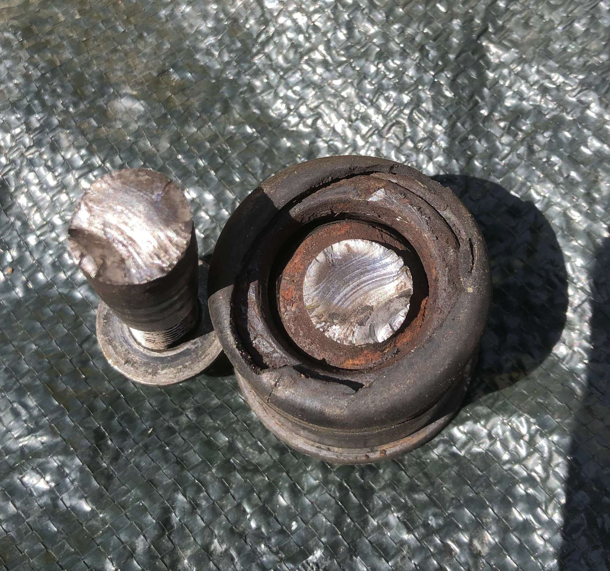

In the last years I've had a couple of wheel bearings go out, and recently a lower ball joint snapped at the grocery store. My friend who is a mechanic said the stiff springs might be harder on the bearings. What do you think? The ride is stiff but has good handling.
After the ball joint broke, I had it towed and I replaced the passenger side ball joint and mangled CV axle (Duralast Gold bought locally). I realized that I had been neglecting the old jalopy, so now I have a project!

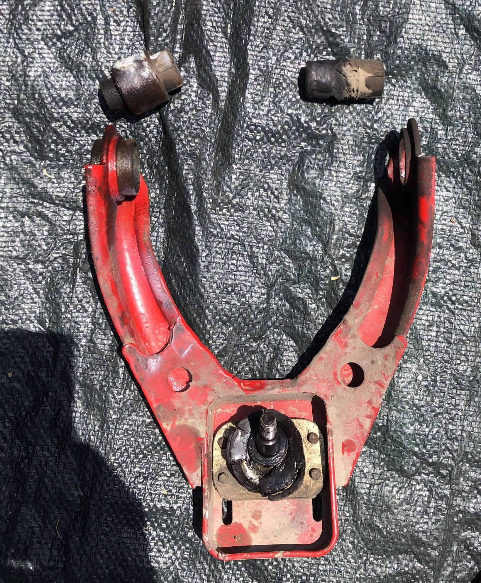

I recently changed out the front UCA assemblies, but these are just Moog with no adjustment on the upper ball joint. I'm not sure if the adjustable ball joint is necessary for the setup, or just for major camber tweaking.

snap!
old left UCA, bad ball joint
old right UCA, bad ball joint and bushings

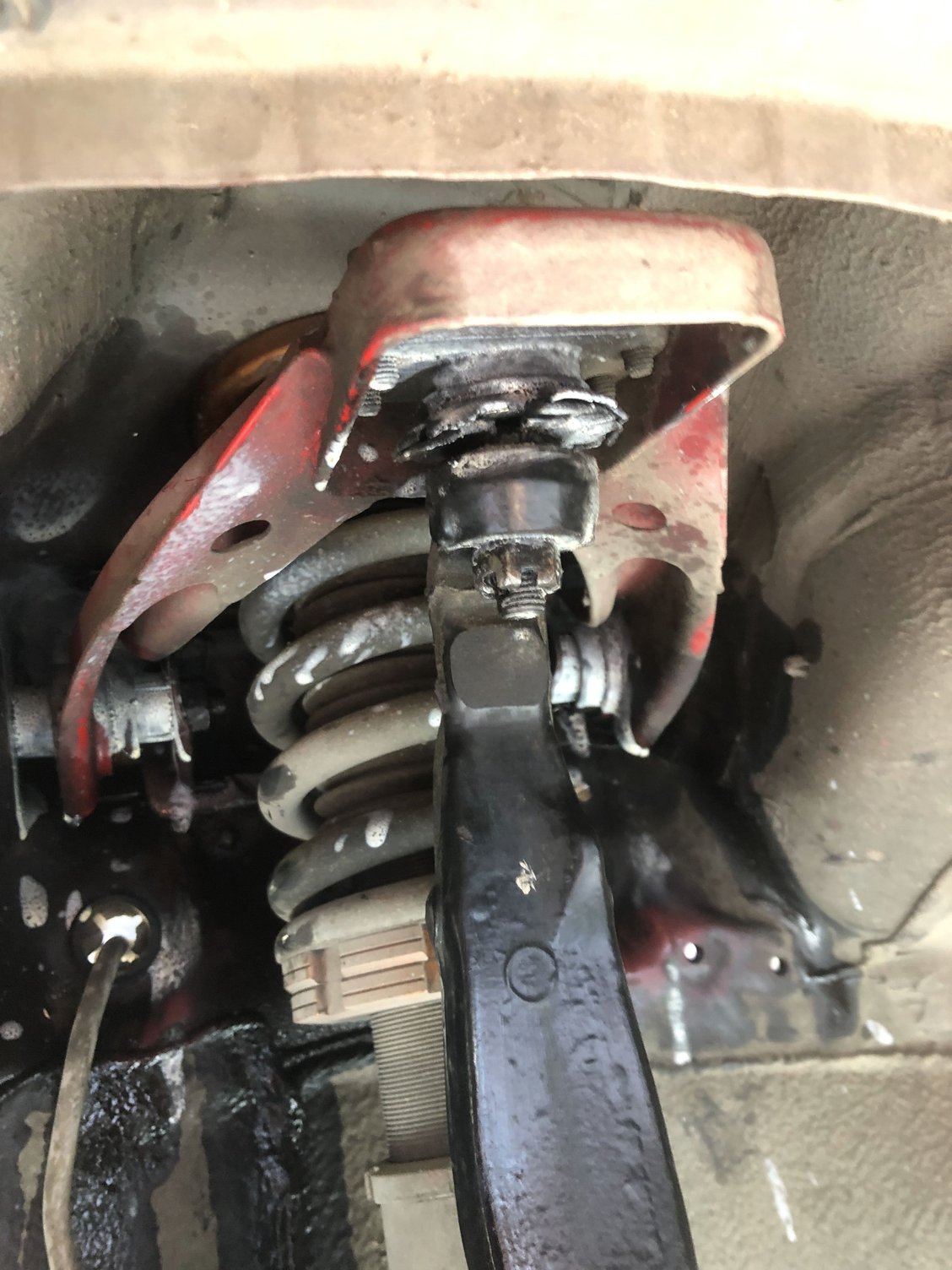

before removal, you can see the coilovers
The castle nuts fly off when you hit them with the impact on a swivel adapter, but be amazed as the socket goes flying with it when it comes off!

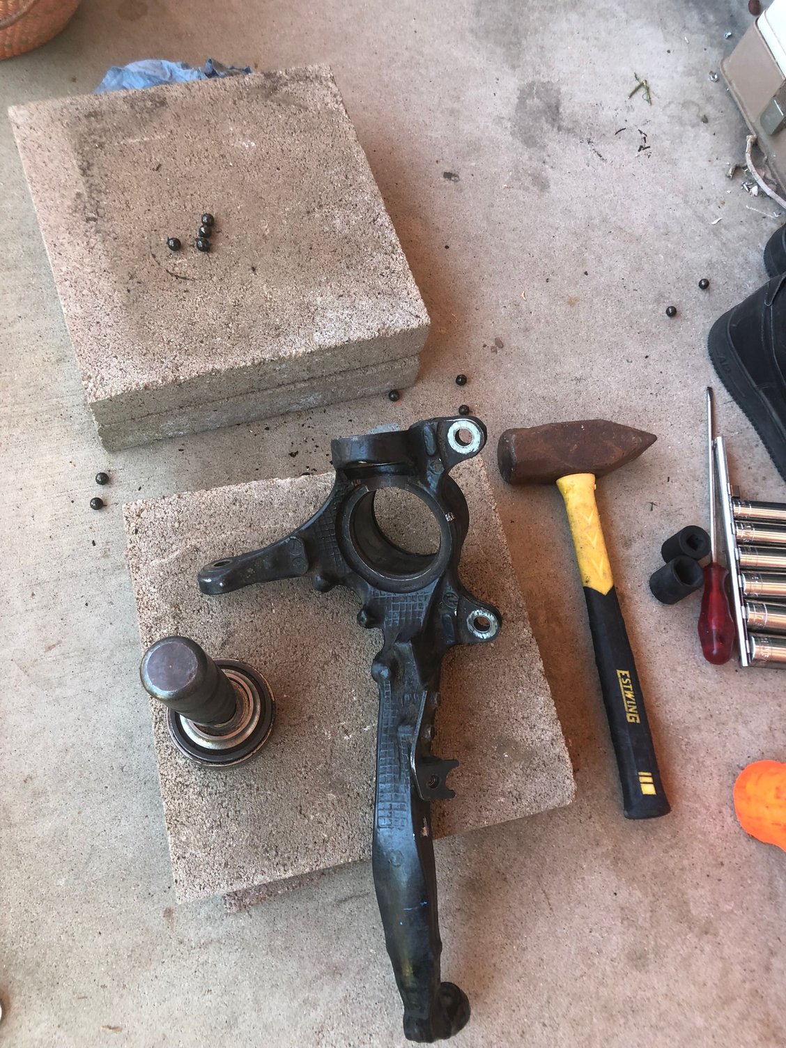

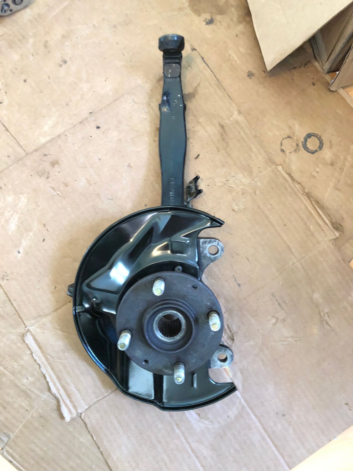

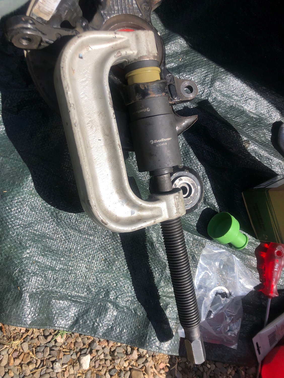

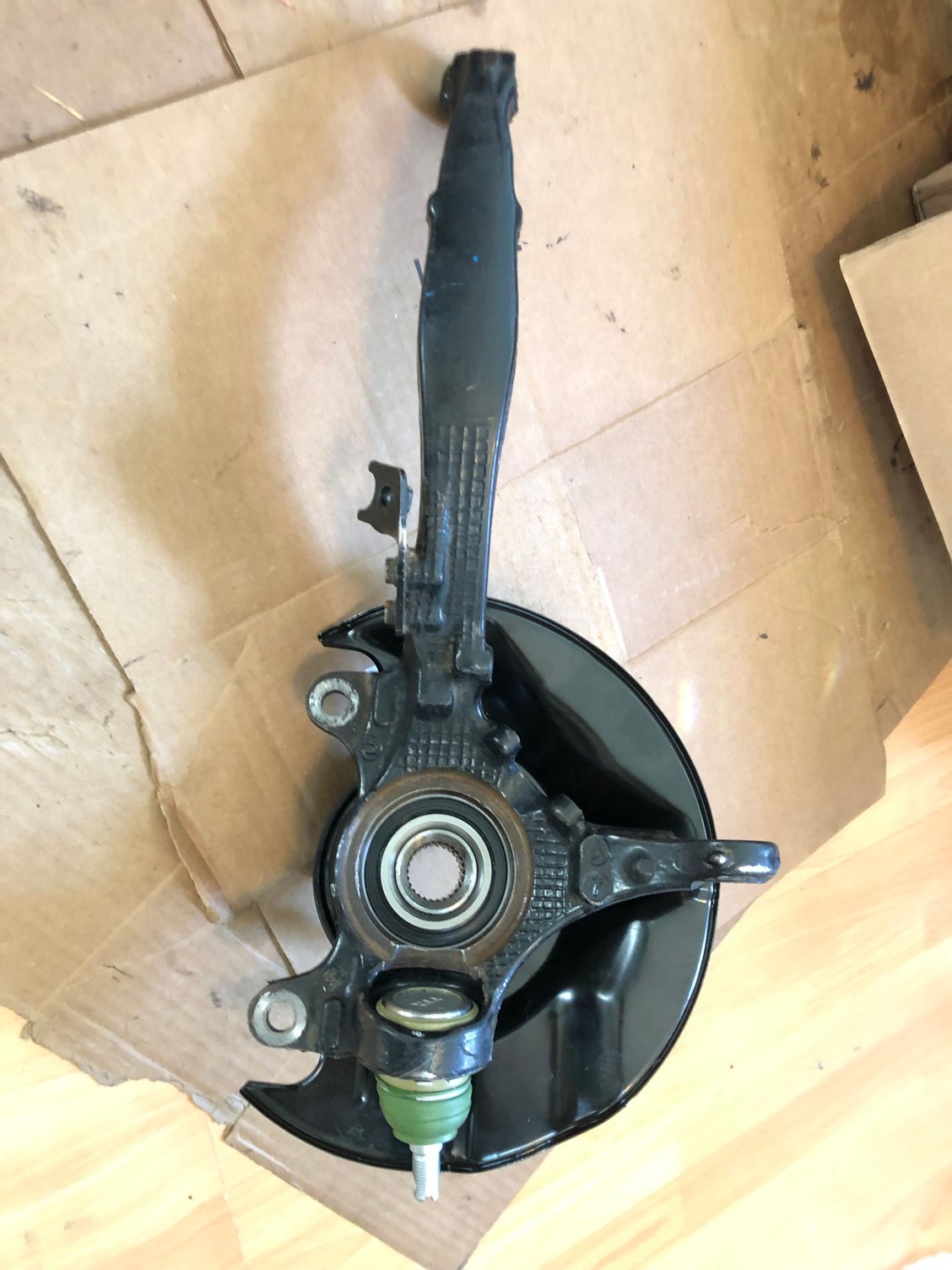

knuckles repaired. New splash guard also

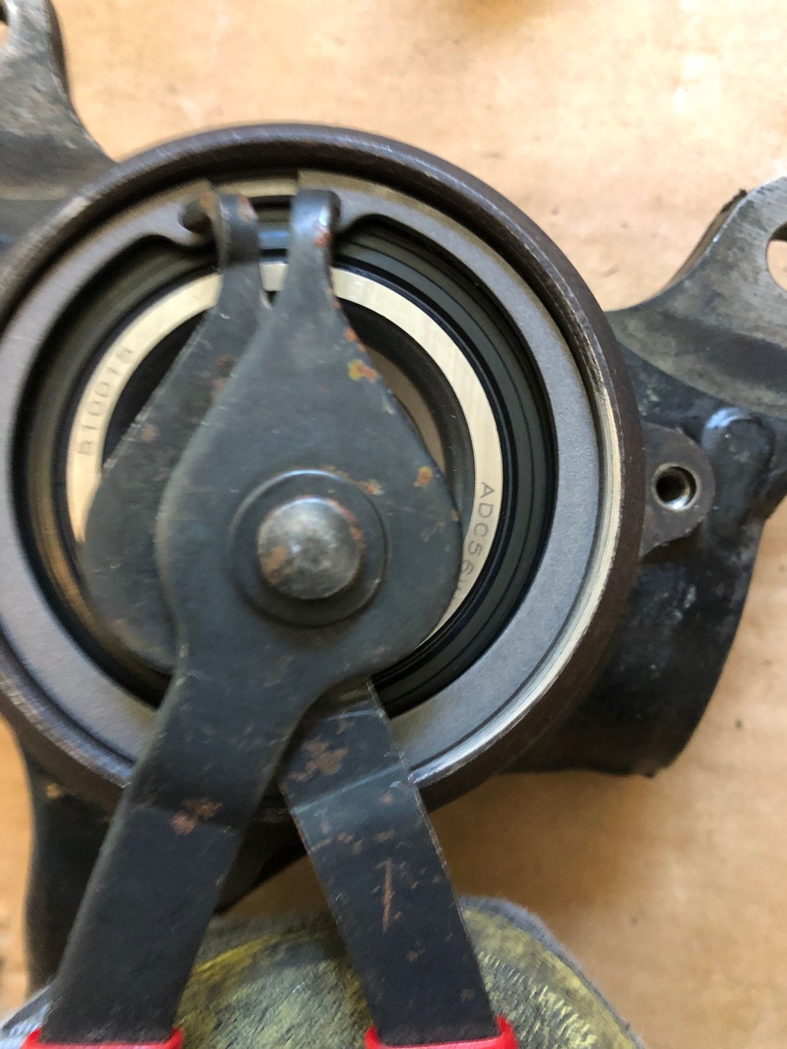

These pliers help a lot

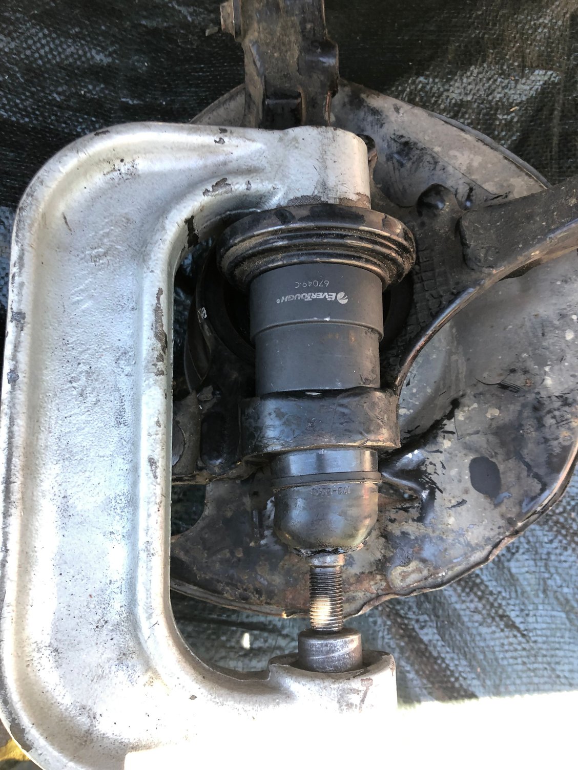

This is how I removed the ball joints.
Install with adapters.
Done, and new wheel bearing.
I used the Harbor Freight bearing press kit and impact to remove partly, then hammer tp finish. Press in using thr kit and hand tools. Takes forever
