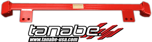

yeah, that's the bar. I put it on before the Test N Tune this weekend and it was awesome. So much better than the 19mm ST bar. I think I am going to get the tanabe lower barce bar (for 92-95 civics it is a 2 point bar). It mounts to the LCA on both sides of the bolt. So it looks like:

. you might want to research subframe tearout with a bar that big. also, like stated above, if you autocross, the best two setups(imo) that prevent this are outlawed for sts from what i read.
also like to say that james from tanabe is a d!ckhead. i would never buy from them again. they screwed me on the front and rear tie bar. the rear i got looked just like that. the "powdercoat" looked like crappy latex paint put on by 1st grader. they slap a crooked piece of tape over the sustec badge instead of putting it on after coating. i believe this is because they are made by two different taiwanese company's. the rear tie on one end-the piece on the end that sandwiches the subframe around lca- was severely crooked. very poor quality. he said it was" not a warranty issue so you cannot return it or exchange it." it is sad because all of their cars(tanabe/signal auto) look fat as hell. my experience. sorry to threadjack and rant.
