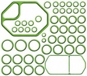

It will most likely be the only ac o-ring kit they offer for your year/make/model/trim. Big chain type stores usually only offer one brand. I can't remember if mine was in-stock, or if they had to order it.
This is what my records show from 2012 on my 89 Crx Si. I used some of the extras on my 94 Civic CX as well. It's probably the same kit for your EM1 too:
- O-rings Santec MT2560 $10.99 Autozone
