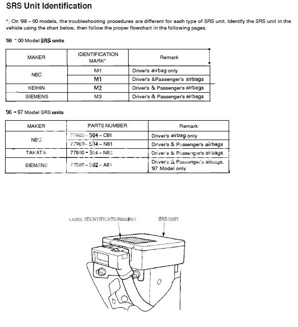

No need to guess. Pull both CEL and SRS codes by jumping the service connector above the ECU. Click the CEL sticky at the top.

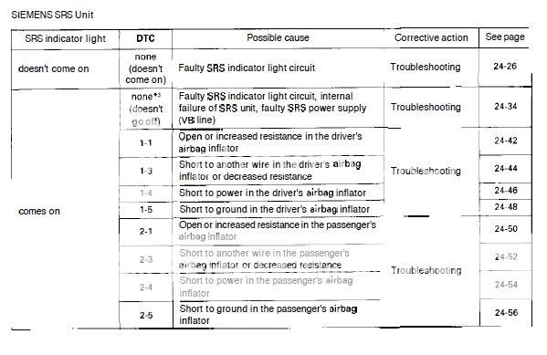

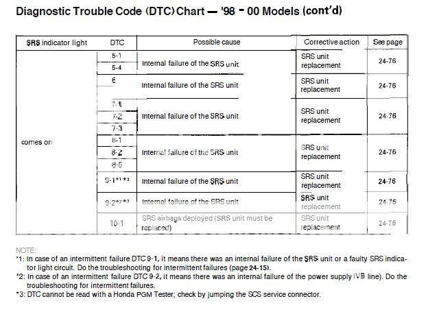

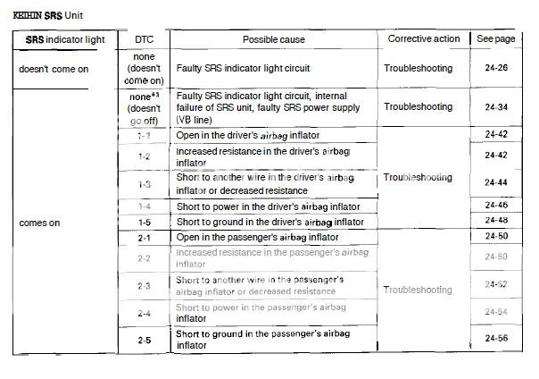

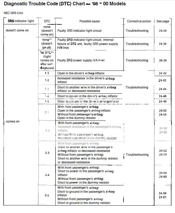

See FAQs sticky to learn how to pull SRS codes from 96-00 Civics.
Here are the SRS codes for 98-00 Civics:
