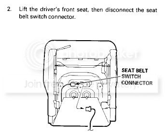

Test the driver's seat belt switch.
If you ground the Red/Blu wire of the seat belt switch, does the cluster light turn on and does the chime work?

Old Mar 11, 2012 | 05:25 PM
Former User's Avatar
Joined: Feb 2008
Posts: 45,214
Likes: 58
Default Re: EJ8 Seat Belt Chime/Light
Old Mar 11, 2012 | 05:31 PM
deving916's Avatar
Joined: Sep 2010
Posts: 499
From: The Dirty South, FL
do i ground the wire on the seat or the one that comes from under the carpet TO the seat?
ps. grounding a wire just means splicing into and taking like a paper clip and touching bare metal?

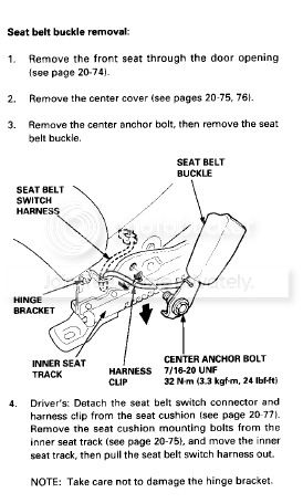

Old Mar 11, 2012 | 05:41 PM
Joined: Feb 2008
Posts: 45,214
Likes: 58
Originally Posted by deving916
do i ground the wire...
Ground the Red/Blu wire on the wire harness side not the seat belt buckle side.
Yes. Ground to the metal frame under the dash.
