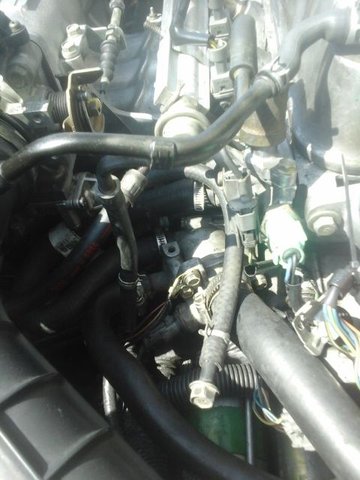

Also noticed that my fitv line that comes out bellow the throttle body is plugged and I looked up the diagram and its not suppose to be plugged. The intake Mani I'm using is from a d15b . I also have a z6 Mani I can use but what's weird about it the Mani's are almost the same besides one vaccume port on the back which hooks into a sensor that goes to the carcoal canister. So idk if I can use it and idk why I couldn't if the z6 Mani is for the z6 engine, maybe cause my ej1 is made in Canada? Idk if any of this makes a difference just thought I'd add it in. Noob here still learning.

Also post clear pictures of the IM, TB, IACV, and FITV.

Z6 Mani that was on the engine when I bought it

Do an ignition system tune up and check the ignition timing.
Connect the coolant hoses as intended:
Also install the D16Z6 IM and connect the vacuum hoses as intended:
The PCV hose connects to the unlabeled IM nipple.
