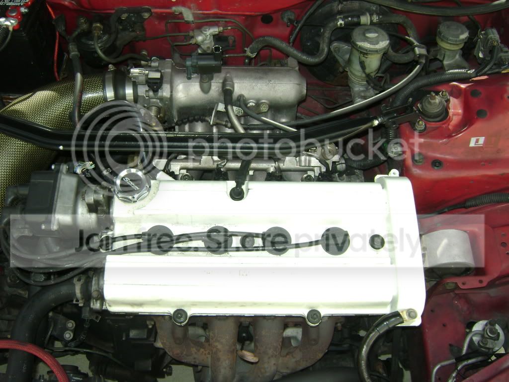

i have a 92 eg with a b18b1 and i need to order some misc. stuff from the local auto parts store,like a valve cover gasket,throttle body gasket,etc.
what year and vechille do i tell them i have for motor parts?
i attached a pic of my motor,its is obd2 iteslf,right? i mean the motor.
and for the valve cover do i use like permatex or some other sealent with the gaskett? or
do install it "dry"?
also the motor is stamper H M does that mean its jdm?or do usdm have them as well? or all b18b's usdm?
thanks for the help in advance!!!!!!

for motor parts tell them the type of car the motor came out of. for example..a civic wth a ls swap out of an integra and you want a valve cover gasket...tell them an acura integra and whatever year your motor is...if it is obd2...just say like 98. simple enough.
and i never put anything on the valve cover gasket...of course i have never got a new one. i just put it back in when i take it out. lol

I beleive the B18b1 came in the 94+ acura integras also are you running obd1 or Obd2

what do your ecu plugs look like? are there 3 completely square or are they 3 rectangle plugs...on tiny one, one in the middle, and one long one? if it is completly square it is an obd2, if it is 3 different plug sizes its obd1.

how many plug are on your distributor one gray plug is obd2 2 gray plugs is obd1

it doesn't really matter if the motor is obd1 or obd2 as long as it is a b18b1 he can just tell them he needs a valve cover gasket and throttle body gasket for a 1994 acura integra LS.

OK so i just checked the car itself is obd1,but i only has 1 grey plug on the dizzy?
and also notice the unhooked sensor on the intake manifold?
does this mean the motor itself was originally obd2 and wired into the obd1 harness?
so when i order sensor's and stuff do i order for them later year integra's obd2?

how did you check the car itself? if it is before 1996 it is obd1...and you can swap an obd2 motor in and leave some plugs unhooked...just make sure they arent supposed to be hooked up. like my hatch has an extra plug for an o2 sensor but i bought a subharness that had another one...so my old one is just chillin. lol

the motor is obd2 wired into the factory obd1 harness.
i have no cel's so i assume everything is fine,agian thanks for your help!
what year did they change to odb2? so i if i have to order a sensor or something ill know.

there should be a number stamped on the head, it'll be like 96 or 99 something like that on the little graphics on the head, it'll be the best way to find out if the motor is obd1 or obd2, if you can get a straight pic shot of the head like looking at straight to the header if you were in front of it, I could tell you what the yr is.

no prob man. obd2 started in 1996...it is obd2a and they have obd2b...i think it started in 2000 (not real sure about that one). but just tell them 96 up and you should be good to go. i dont really know what the difference is between obd2a and obd2b. lol

they have obd2a from 96-98 and obd2b from 99-00

my camera is out of batteries but i just hit the head with a wire brush,and on the first set of symbols i got 00 so its from a 2000?
other then that their was a p75-5 stamp,H.M. stamp and some jap lettering,lol
