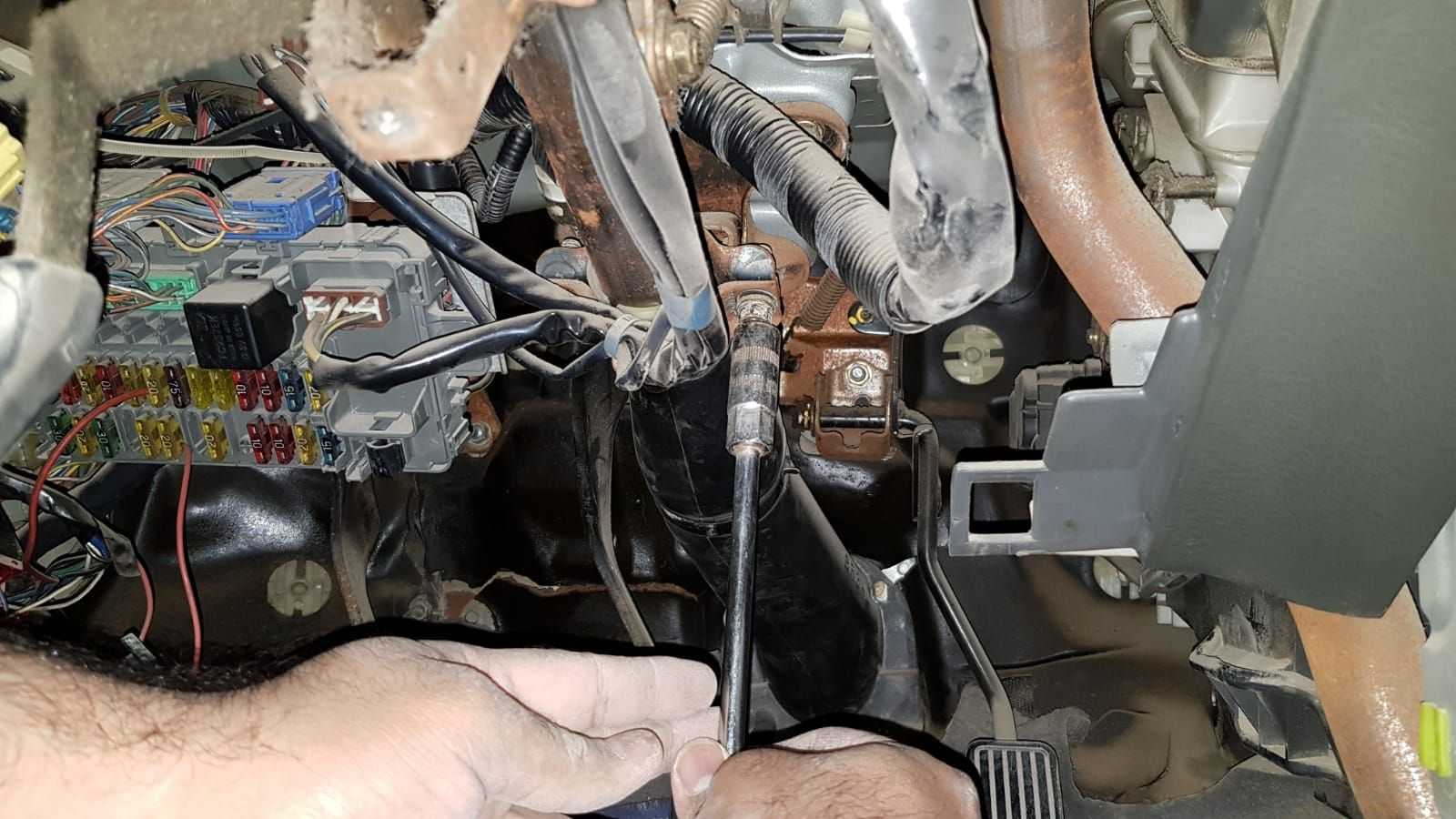

Bought some goods for restoration and completed front suspension work

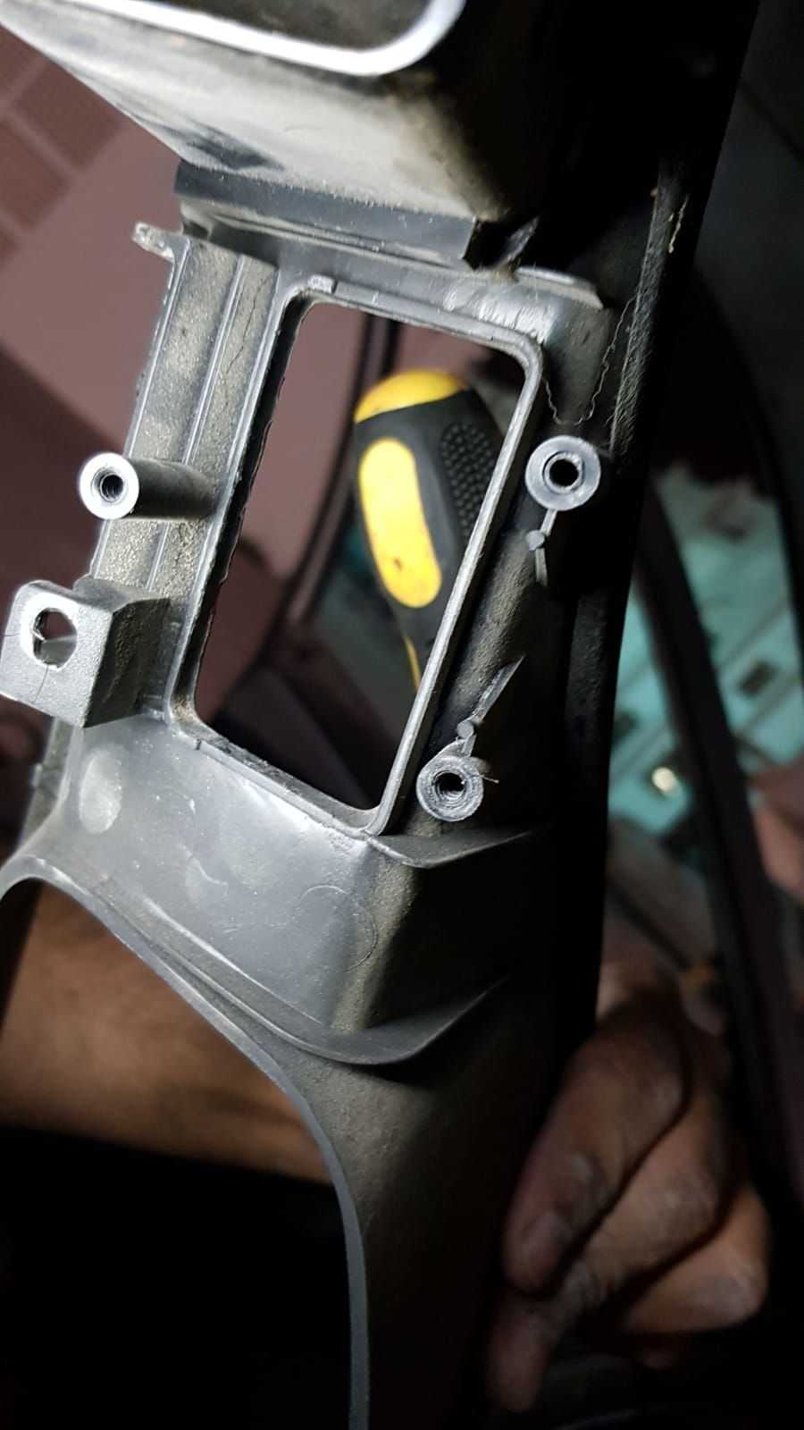

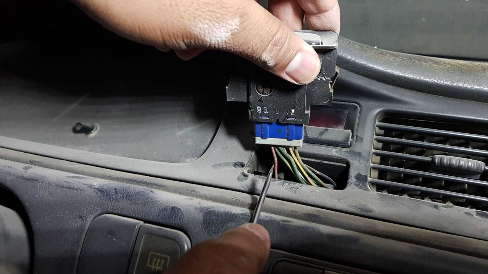

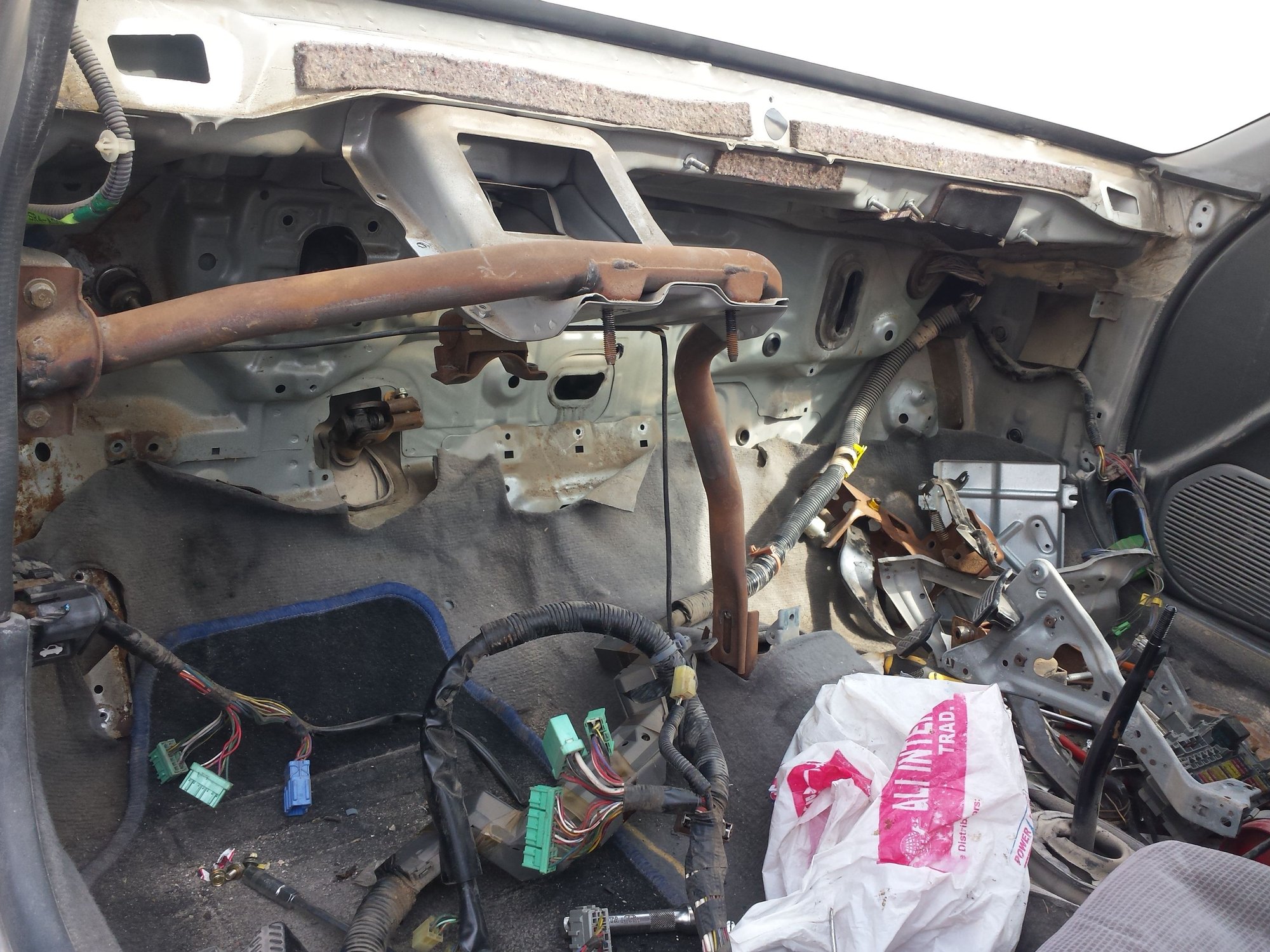

As i didn't had any motor neither any front cabin parts including dashboard or any engine bay components ...... somehow i managed to grab this 95 ex from another friend of mine
who abandon his car for more then 5 years due to seized engine. d15b3 carby

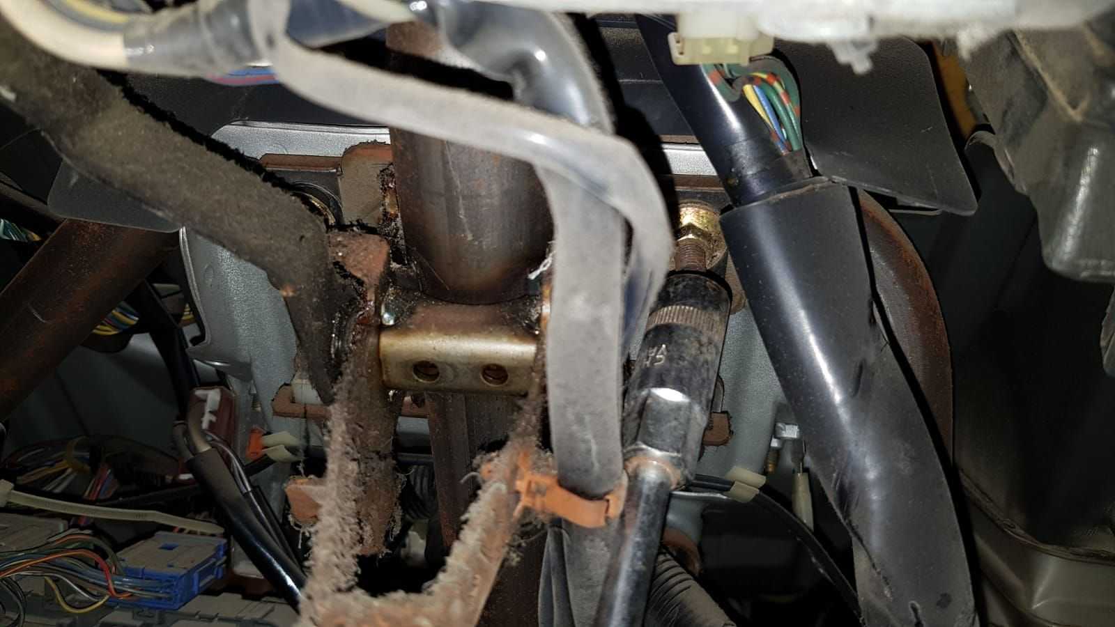

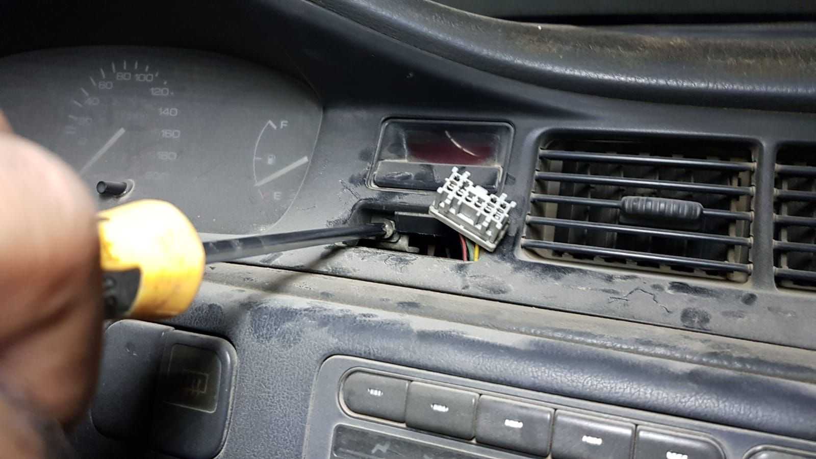

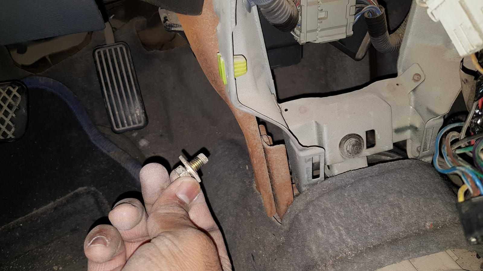

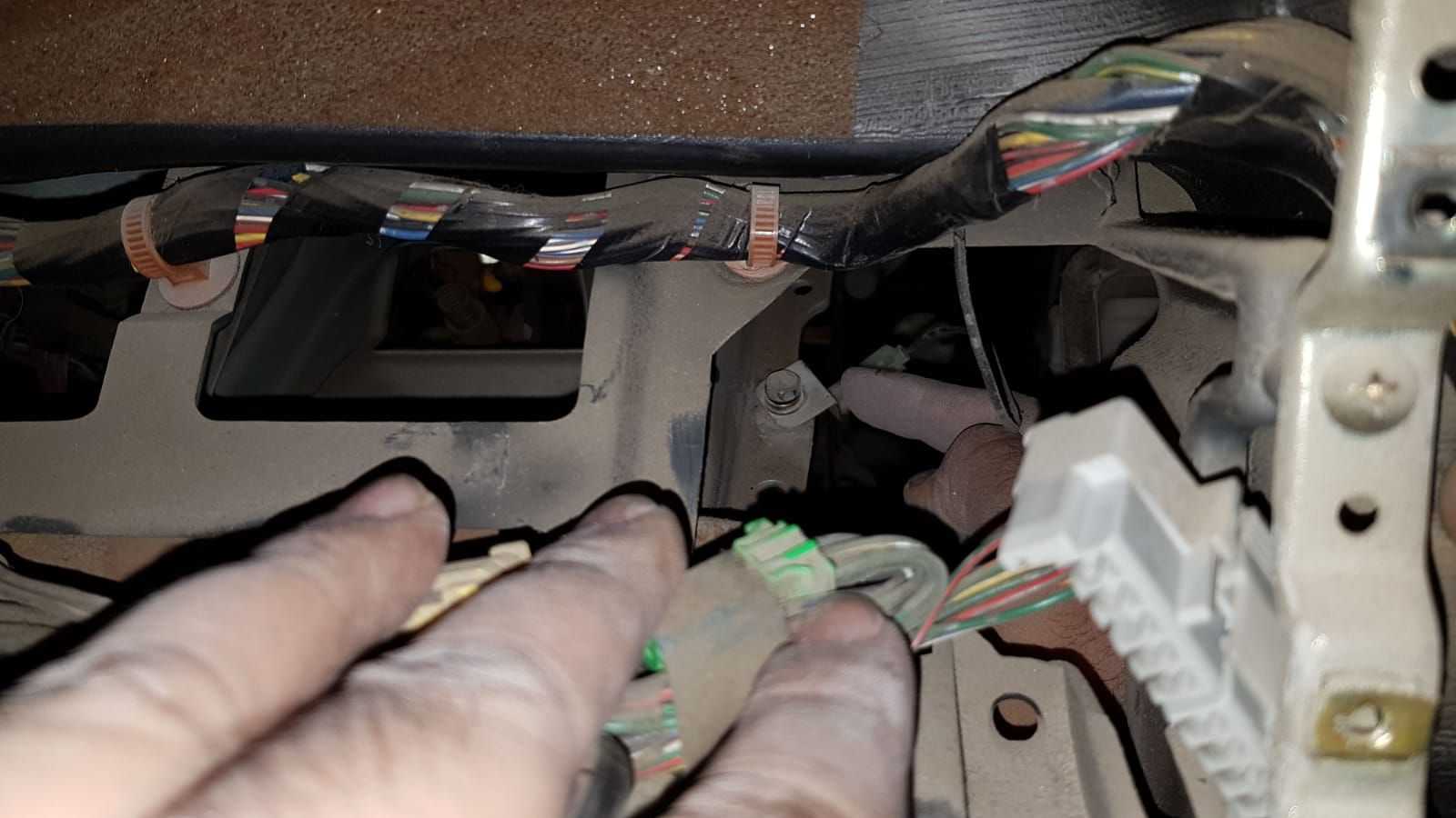

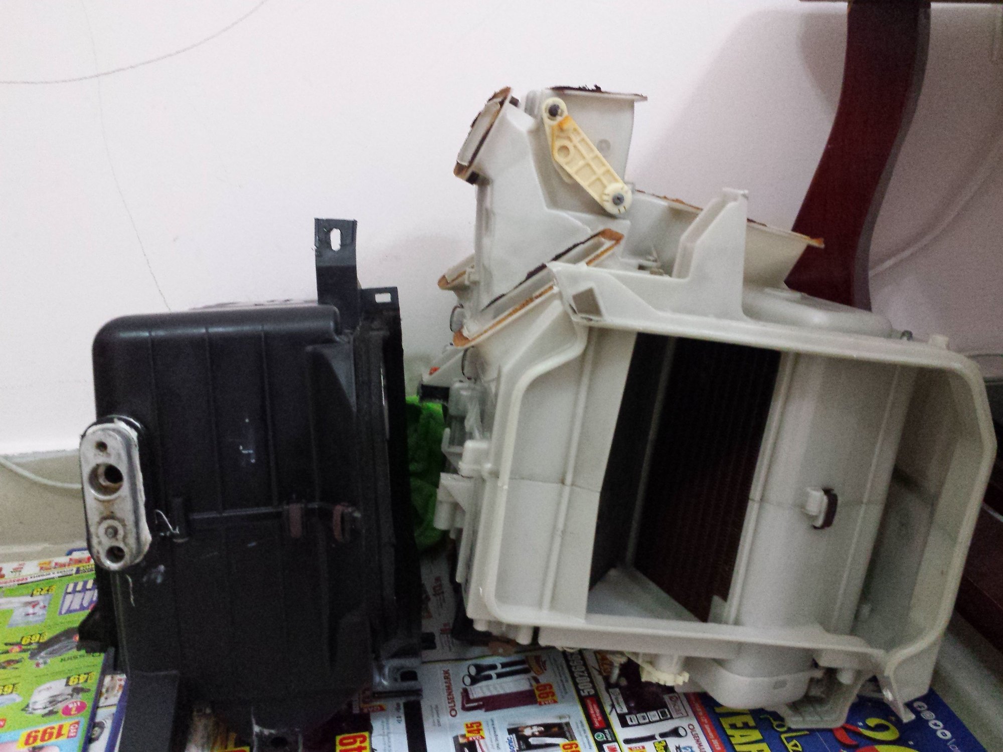

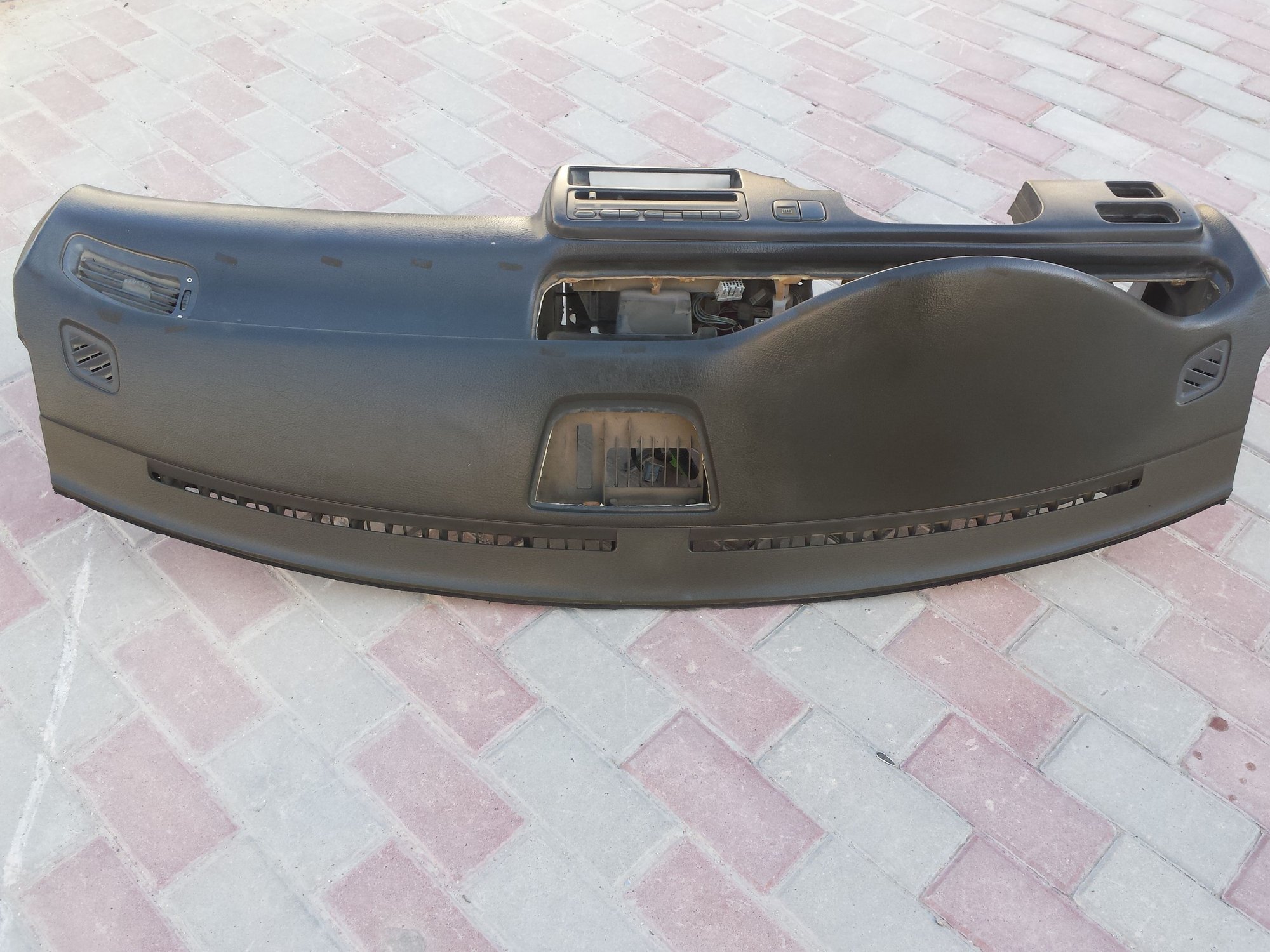

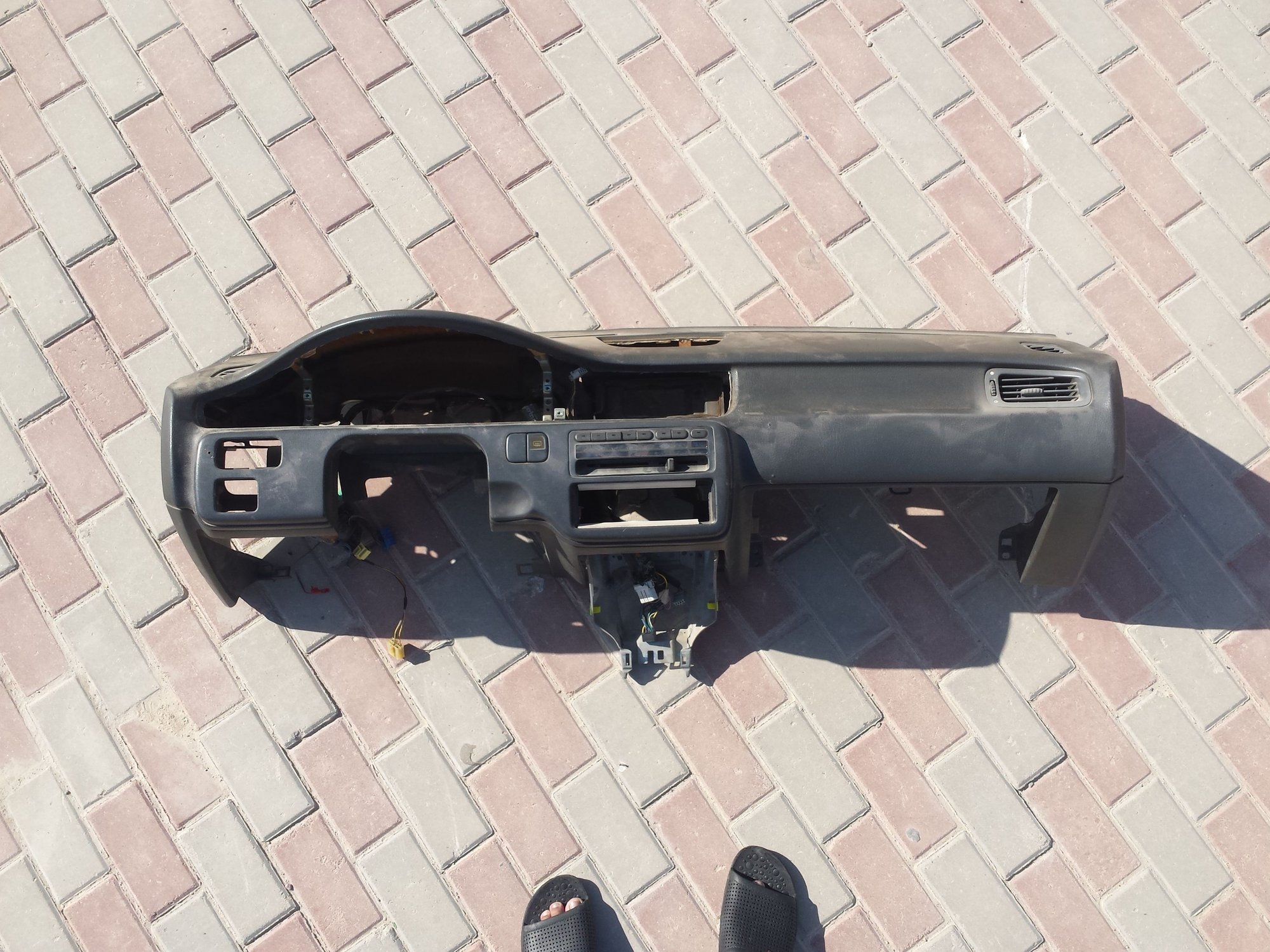

Since i have a donor kind of a car to use and swap the parts to restore the civic ..... Lets part out the whole ****
Uploaded the pics in reverse order

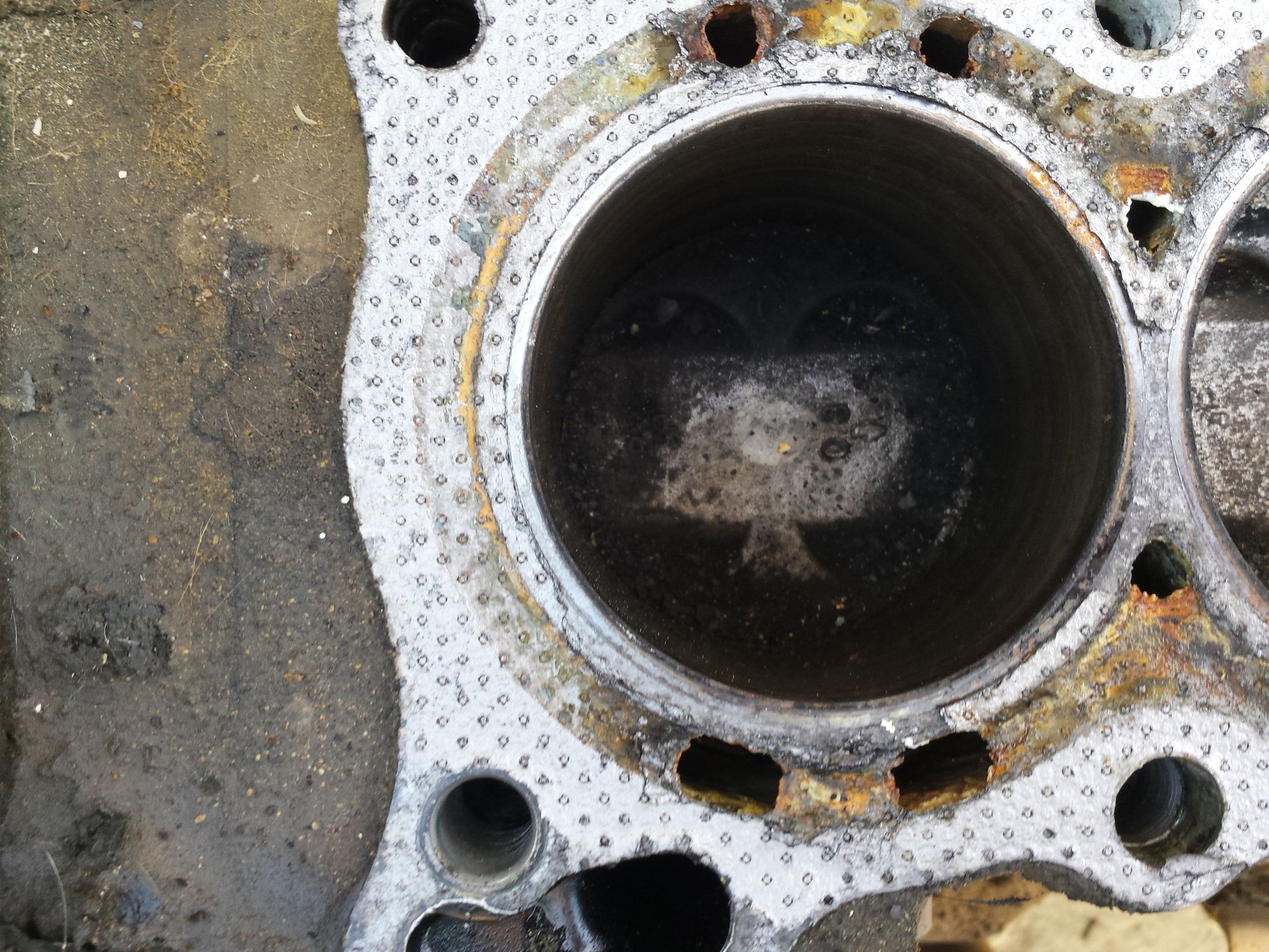

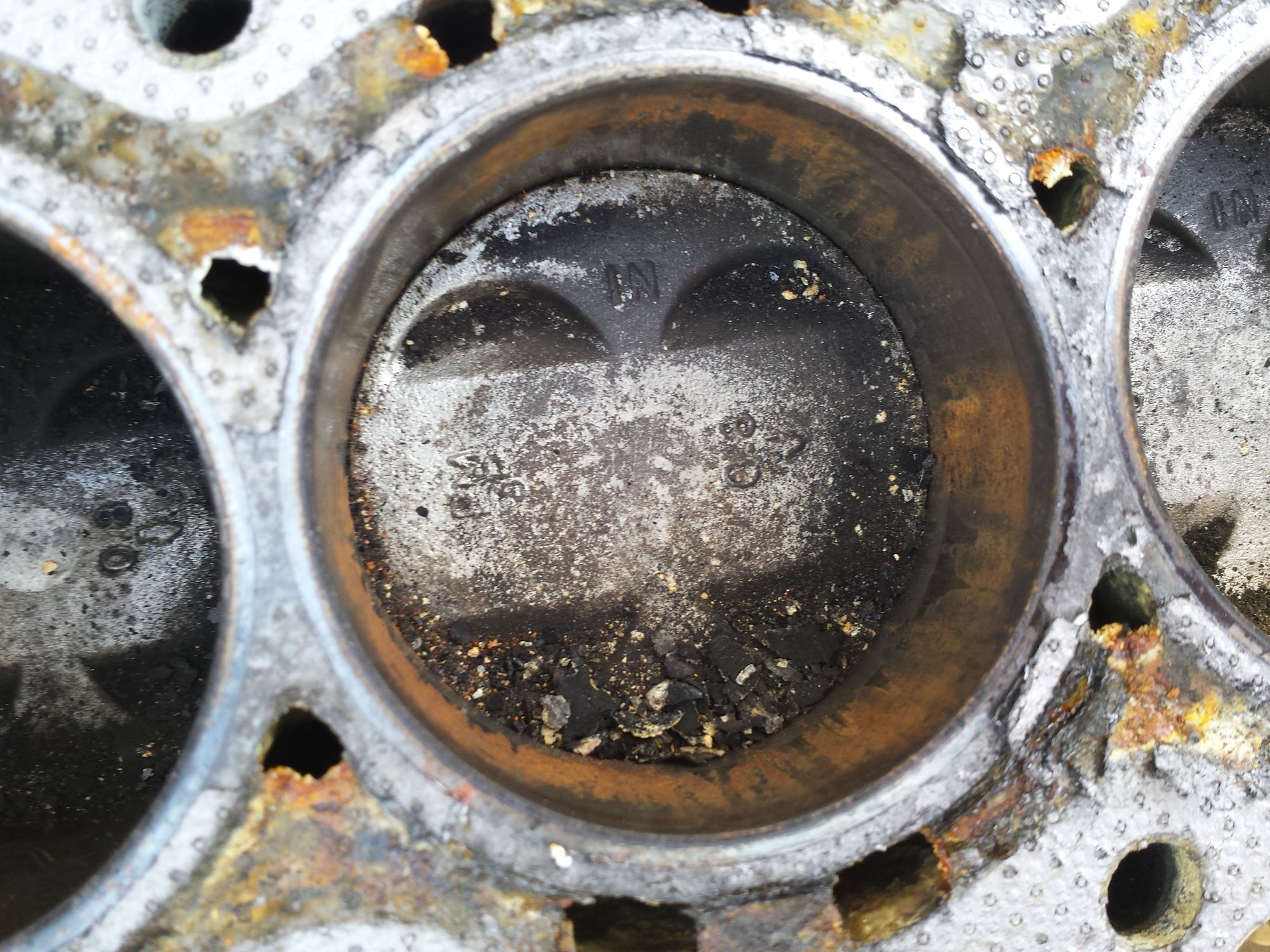

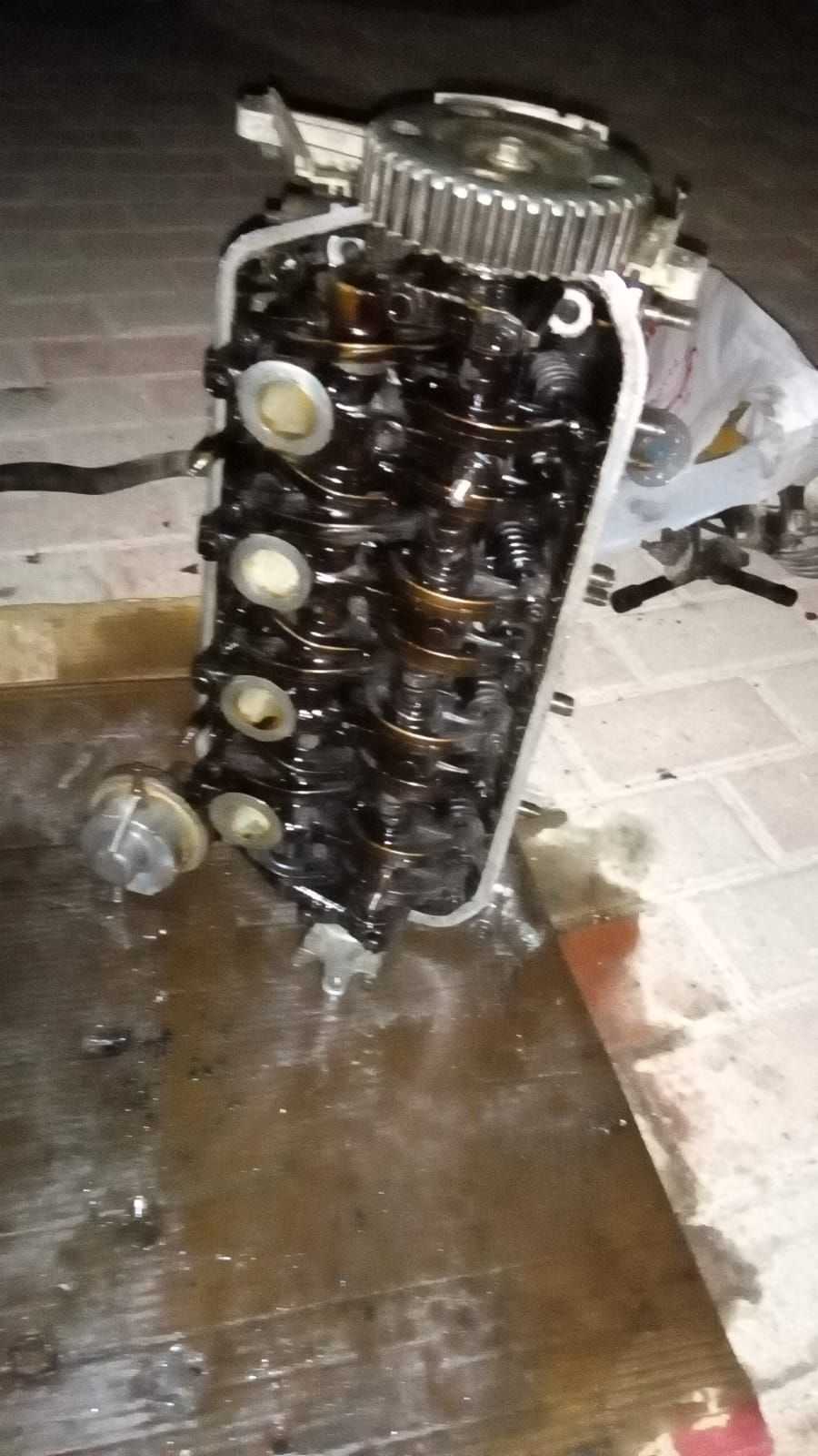

It was the time to remove the head and see whats the condition and it was like yukh......
It wasn't even rotating using breaker bar

Did some head and block surface using sand paper with sanding kit in house

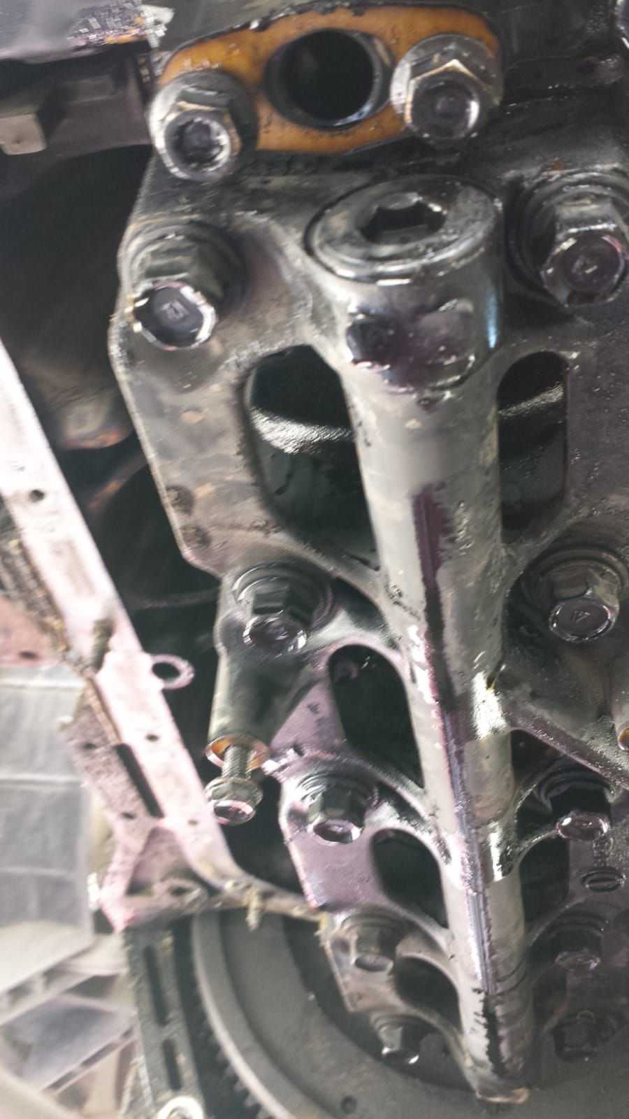

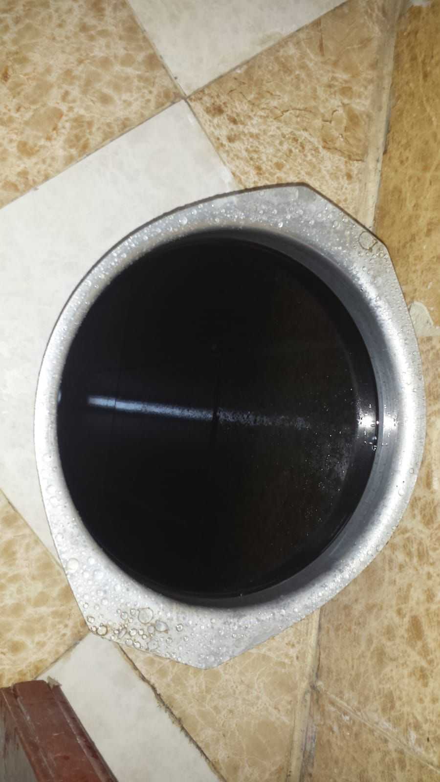

It was time to put it back and set the timing and replace timing belt and head gasket, at the same time used almost 5 liters of gasoline in place of oil to remove sludge and dirt
out of the oil pan and it was like PITA ... it took almost half day to get the sludge and debris clean from the pan ..... no sign of any metal particles or pieces
tighten up the crank bolts to the torque specs and clean the strainer filter in the pan.

The story now is that the engine takes some force to rotate while rotating through main pulley bolt 17 no. size, I used the pickup truck to toe around the yard and it improved a bit but still the same.
Its cranking cams rotate but stuck at one point then i have to apply the force using breaker bar and it gets out of the stuck zone. Took out the carby to give a general clean
Old 06-13-2019, 02:11 PM

With all of the dust and dirt in the pan, and the area where you live being very much dirt covered, I believe you will find the piston rings have damaged the cylinder walls. The crank is probably scortched as well. I believe you will have to hunt for another engine

Well i hope that the engine stayed ok , yeah its a place full of dust in the middle of the desert. Hatchbacks are very rare here so that is the reason i am not scrapping it .......... Looking forward to get the engine kick in.......
The issue with the engine is it was seized and it was not even rotating with the breaker bar ....... i used WD40 and filled the cylinder wall and let it soak for 3 days .... somehow i got the engine rotating but there is a point during rotating at which engine takes some force ...... I tried to tow the car on 4th gear
initially it was jerking ..... then it got smooth ....... but when i crank it .... same thing it stucks on the same position ..... I guess i have to tow the car at least 2 3 miles with 30 to 50 miles / hr so the piston could be set free and the oil could circulate the engine...... once its easily rotational then i shall
crank the engine back again...

Yeah. I would still disassemble the engine, at the very minimum you need to re coat the main crank bearings, but at that point your should just replace them
Here is an awesome rebuild thread with everything you need to know
See this as an opportunity to make a name for yourself. You mention mechanics being dishonest in your area, make your name as the honda expert, do a little more
https://honda-tech.com/forums/honda-...tures-3051143/
