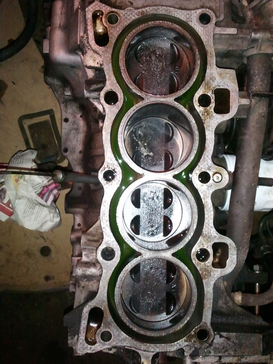

Old 10-24-2014, 05:31 PM
JPRhome's Avatar
Join Date: Mar 2014
Location: Lincoln City, OR
Posts: 72
Default Re: D15B7 Won't start after head replacement.
Just throwing these up not sure if the pictures will help but the cylinder walls seemed fine although I did not check them physically they did not seem to show any ware visually.
Old 10-25-2014, 10:24 AM
Hysterically Calm
TomCat39's Avatar
Join Date: Jan 2013
Posts: 10,382
Received 562 Likes on 481 Posts
Those pistons look really clean, that isn't a pic immediately after pulling the head is it?
Both my motors have some to moderate carbon build up on the pistons. Hard to believe that is an after use picture of the block. The whole thing looks just way to clean.
Old 10-25-2014, 11:39 AM
JPRhome's Avatar
Join Date: Mar 2014
Posts: 72
My brother cleaned the tops of the pistons but the cylinder walls seemed okay to me.

I installed a new intake manifold gasket upon assembly and torqued, in to outer to specifications, all vacuum lines are secure with no leaks that I know of new fuel filter was installed in march this year.
