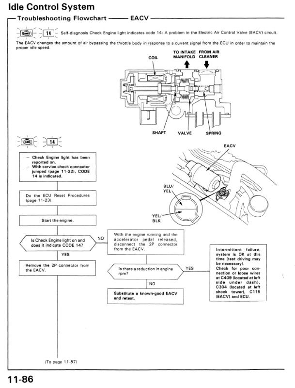

I'm only throwing code 14 (Idle Air Control Valve) but I'm not sure if that would cause this... I don't have a rev limit set on my chip. I haven't been able to drive it yet because I still need to bleed my clutch, but I doubt that would cause the limit...
For the plug that goes to the IAC, what color are the wires? I may have simply plugged the wrong thing up to it...

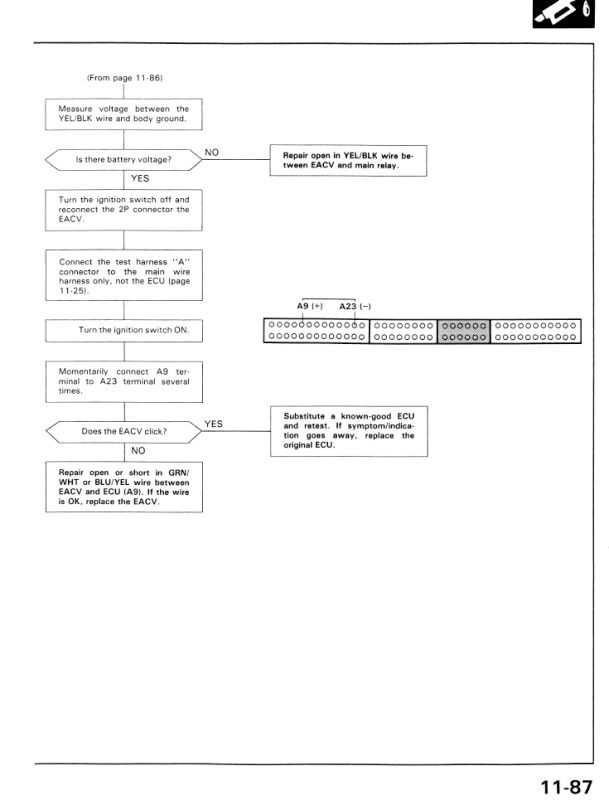

BLU/YEL and YEL/BLK are the colors on it.
I doubt you plugged it in wrong, because if you did you'd more than likely be throwing two codes.

not having your iacv hooked up will cause you multiple problems im not sure of the colors by heart but check to see if u have a round two wire clip hanging unplugged behind and under your intake.

Troubleshoot this issue, once you have the code resolved we will see if the problem is still present then go from there.

Ok, got the IACV figured out... had the wrong plug on it... ha.
