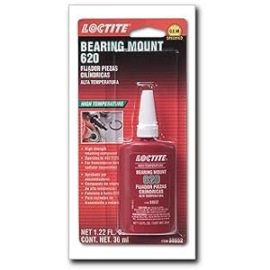

That's a pretty small chip. If you're really worried about it use some Loctite shaft and bearing mount on the bolt and crank it on there with a good inpact gun. I legitimately ruined the keyway in my crank when the bolt backed out and the pulley came loose. Replace the pulley and key and jammed a ground down finishing nail in the keyway, put some shaft and bearing mount on the bolt, it's held up for the last 30,000kms.

what is loctite shaft and what is bearing mount??? are those some special lock thingy. Okay so u ruined the keyway when you remove backing out the pulley???? so ur saying i can put also a small nail inside the damaged areA???
what is shaft bearing mount.
Old 04-29-2013, 03:13 AM
Seagull Management
94EG8's Avatar
Join Date: Jun 2008
Location: Miramichi, NB, Canada
Posts: 15,150
Received 24 Likes on 22 Posts
Default Re: Is this crankshaft keyway slot useable???
No, I'm just saying mine was damaged far worse, repaired it in a prett ghetto way and it's still holding together. You wont need a nail.
Shaft and bearing mount:
It's stronger than threadlocker.
