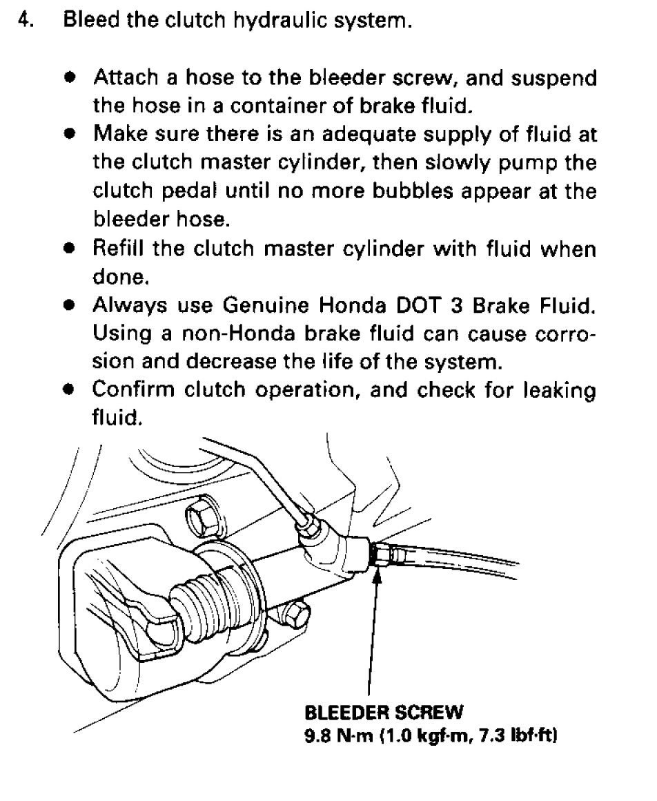

How did you bleed it?
Just the basic way, one person pump then hold while the other release the 8mm on the slave cylinder.
Old 06-08-2019, 04:01 PM
muellersfan's Avatar
Join Date: Apr 2018
Posts: 3,719
Received 328 Likes on 308 Posts
Default Re: Clutch petal have NO RESISTANCE. HELP!
From the factory service manual:
Do it like this^
