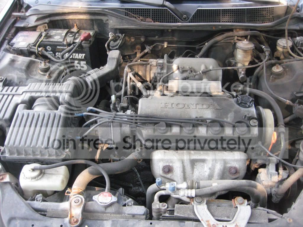

So ive recently swapped out my engine on my 1994 honda civic ex, its got a p28 ecu and just dropped in a d16y8. For some reason im not getting any spark from the distributor and it was working fine. I swaped out the rotor and but a new cap still nothing. I did swap the manifold from the y8 but everthing hooked on right. When i go to start the car it turns strong but no start and my sterio resets its self. I have a little green light next to my steering wheel (im guessing its wired to vtec or shift like because when vtec kicked in the light would turn on) but instead of staying off it flashes on and off and i hear a clicking noise under where the fuse box is inside the car. The car was fine before the swap and didnt even have a check engine light (that turns on too). I took out both fuses for the ecu and unpluged the ecu but the dash keeps doing the same thing and it still wont start. I checked my fuses in the outside in the engine bay and non seemed burnt. I was getting a weird backfire of gas out of the manifold for a couple days then it stopped and now when it turns it does it again. I have fuel going into the engine i know thats for sure. I cant seem to find the problem at all and im stuck. Any help? Thanks!

Old 10-15-2015, 02:55 PM
Eddygee53's Avatar
Join Date: Oct 2015
Posts: 92
Originally Posted by RonJ
Check whether the hood Back Up fuse is blown.
How did you test for spark?
Post pictures of the inside of the distributor.

Old 10-15-2015, 03:10 PM
I never narc'd on nobody!
NotARaCist's Avatar
Join Date: Nov 2013
Posts: 9,537
Default Re: Brand new battery but stereo resets and no spark
Uh...something looks decidedly wrong there.

Old 10-15-2015, 03:14 PM
NotARaCist's Avatar
Join Date: Nov 2013
Posts: 9,537
Look at where the "flat point" on your distributor is. Now look at where it is on this motor.
And this one.
And this one.
See what I'm getting at yet?
Old 10-15-2015, 03:21 PM
Eddygee53's Avatar
Join Date: Oct 2015
Posts: 92
And this one.
And this one.
Yeah but its a y8 on obd1. Its running a p28 ecu with obd1 harness. My distributor is a TD-42u i have a TD-73u but it doesnt fit the harness and when i repinned the dizzy to fit the harness but it didnt work either
