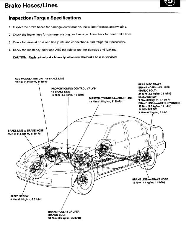

Old 12-30-2014, 06:22 PM
Former User's Avatar
Join Date: Feb 2008
Posts: 45,219
Received 44 Likes on 22 Posts
Default Re: Brake lines
Old 12-30-2014, 06:36 PM
ek9_beast's Avatar
Join Date: Dec 2014
Location: Baltimore, MD
Posts: 647
Nice diagrams. The plastic cover is to the left of label B
