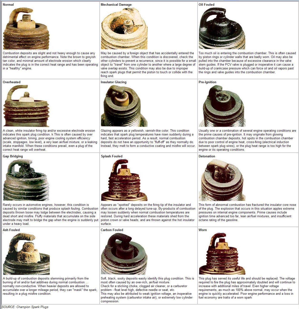

Just removing the spark plugs to look at the business end of them can tell a lot about engine condition. If the spark plugs are in and the timing belt is on, you should feel compression resistance every 180 degrees you turn the crank. If you feel compression, compression, then it just spins over through one cycle, there is a dead cylinder.

here's to hoping it aint melted!
https://www.ngksparkplugs.com/about-...d-a-spark-plug

To add to this: Remove all spark plugs first for easier cranking. Follow up the dry test with a wet (cap full of oil) test in each cylinder. If compression rises significantly then could be a compression ring(s) issue.
Also, as mk378 mentioned..inspect spark plugs:
