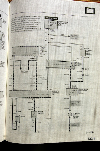

Just sayin' here that there WAS an OEM optional security system that included remote power locks for the 5th Gen. But why you would want to try to source 20-y.o. technology when you could get brand new aftermarket is beyond me.
OP: there are plenty of choices for just remote locks ... look at anything by DEI, for starters. However, I would strongly suggest that an actual security system (begin by reading THIS) would be a much much much much much much better idea.
Incidentally I own one of those JDM infrared remote locks setups mentioned earlier in the thread (came on a junker I bought). I'd never bother putting it on my ride because it only works within 2m from the car .... and you have to walk around and aim it to the passenger's side!! (ie., the driver's side on a JDM RHD car.....)
Where was this option available?

deschlong, can you post a more zoomed picture of the circuit diagram as this could benefit members who happen to have the option.

Default Re: Adding Keyless Entry
OEM security system was offered in Canada in 1993, then Canada & US beginning 1994 - if I recall correctly.
Diagram is multi-page and different for Canada vs. US. I'll post proper scans instead of pics. Until then, this link will have to do.
Beautiful - thanks man.
