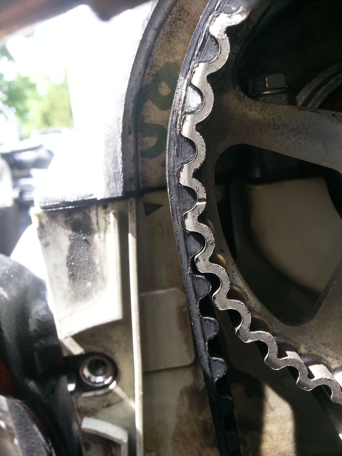

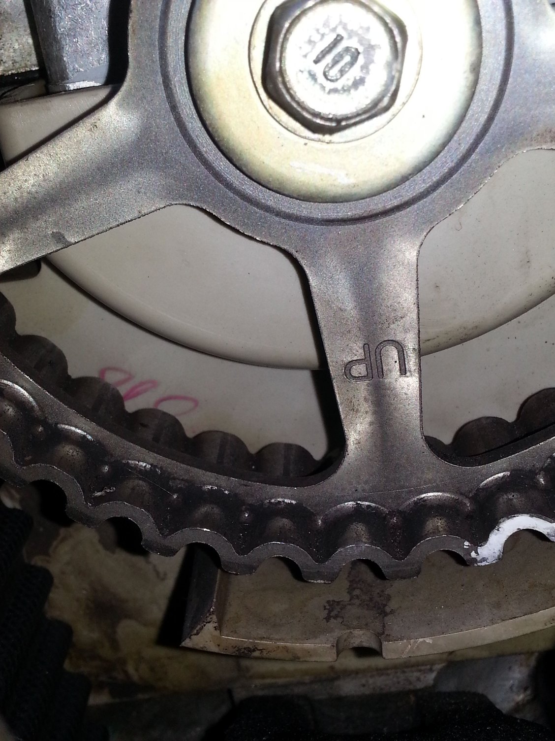

I just got back from checking the mechanical timing and the cam is 180 degrees off....
At TDC
it looks off but I couldnt get my camera straight above it.
the timing belt looks in pretty good condition, do you think I could reset the timing and reuse the belt and tensionor for now?

Oh wow, 180 degrees? I would be wary about reusing the belt or the tensioner. If the belt slipped it probably grinded down a bit and if the tensioner failed and caused the slipping, it's just going to happen again.
I would replace them both, if it was me.

No, it's not. There's a groove on the crank it all slides over. The cam is literally off by 180 degrees and that is your problem. I'm actually surprised you had it running, especially considering that the valves don't seem to be damaged (lucky).

Turn the crank all the way around exactly once, and "UP" will be near the top. Then look at the marks for exact timing.
If the belt has skipped, it will do it again if you try to reuse it. Put a new one on.

Oh, in case it has to be said, be sure to turn the crank to about halfway between tdc and bdc before you take the belt off, so you don't hit the valves when turning the cam. You can take the spark plug out of one of the cylinders and measure where it's at with the dipstick to do this.
One full revolution
So cam timing is pretty dead on.

I can't see any of the marks in your pictures. There are three notches in the edge of the cam gear. They should line up with the plastic pointer at 7 o'clock, and the edge of the head at 3 and 9.

When you can see the tooth pattern on the flat side, it's a pretty old belt. You can often see bad by looking but you can't ever say for sure that it's good.
Do the notch marks line up? If the cam is properly timed, the question then is why is the compression so low?

I ordered a new timing set and water pump last night and I got some better pictures of the cam
