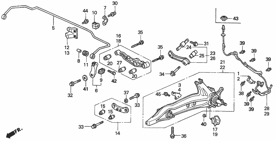

Toe is controlled by adjusting where #14 bolts to the body. So, it is totally adjustable.. Now, you may be right about a bent arm, tho they are pretty hefty, so if bent, it should be obvious..
I'd get a 2nd opinion. Goodyear etc. will check it for free and have him show you whats wrong while its in the air.. Maybe the guy didn't know where it was at..

To elaborate a tad bit more, the area where #14 attaches to the body is slotted so that the arm can be pulled in/out a certain amount to compensate for toe alignment. If maxed out then adjustable toe arms can be installed for increased/decreased length.

This is me just asking the question, not trying to come off as a dick. How is that section adjustable based on the picture? Are the slots the bolts go on thicker than bolt for movement? Just thought rear toe was effected by other adjustments, not independently adjustable.
Edit: Was too focused on the picture and not 24TEN's response......thanks!!

I have adjustable rear toe arms already on there but they are still too LONG. I need even shorter ones. There is an adjustable rear camber kit installed
Old 08-01-2016, 06:44 AM
DryFartWetDog's Avatar
Join Date: Feb 2016
Posts: 26
Default Re: 95 civic lx - Lateral arms?
Area 14 is the place I'm having trouble. I bought adjustable toe arms for that reason and they are still too long.
