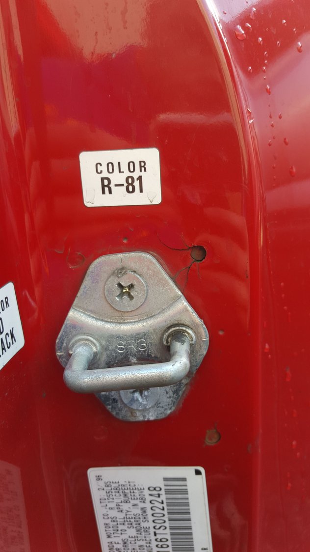

1. Metal breaking around door latch.
I've thought about this one for quite some time and came to the conclusion that since the door is quite long and only supported by the hinge, when the body flexes, the door is resting on the latch and bends it back and forth until it breaks.

All pictures taken are of my:
1996 del Sol SI
D16Y8 manual
