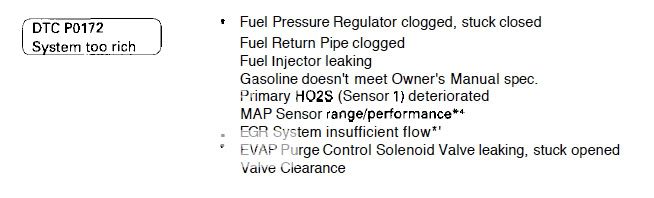

Default Re: 2000 civic si, sputtering issue (matthevelli)
You may want to check the fuel pressure regulator, fuel return pipe, and the EVAP system solenoid valve.
