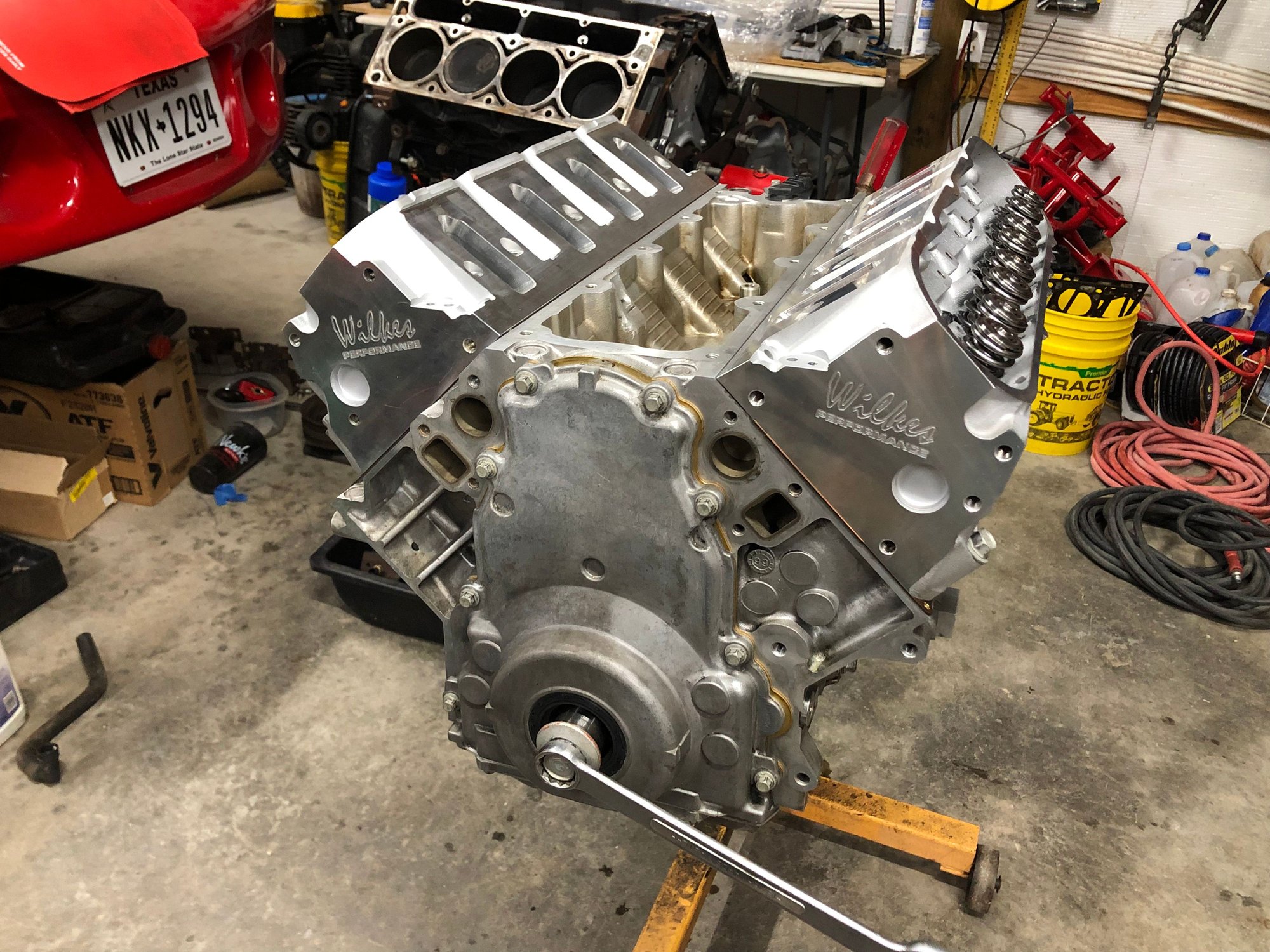

That’s really good news. I can’t remember off the top of my head but what year did you say your car was again? Like I said in that last post, the plugs are different between those year models, 96-98 (OBD2a) and 99-2000 (OBD2b). For the fact that it came out of a manual, that’s perfect and especially if it came out of an EX that would be even better because now you can literally put the Y8 head on the car and either swap the engine harness or modify the necessary wires to allow you to have VTEC! It adds nice little pep to the car, especially being a manual!
99’ LS1, CNC’d port and polished 243 heads, BTR hardened push rods, BTR titanium valves spring retainers and clips, BTR dual spring (valve springs), BTR Stage 2 trunnion kit, Chevy coolant/freeze plugs, Chevy oil barbell, new LS1 BTR head gaskets, Chevy performance oil pan gasket, Chevy performance front & rear timing cover gasket’s, Chevy rear main seal, Chevy crank pulley seal, Chevy oil level sensor, Chevy cam sensor, Chevy knock sensors, FAST 92mm intake, WARR 92mm TB, still need injectors.
Post some pictures up on here when you start or if you already have, I would like to see progress. I’m currently working on some thing with a few more cylinders
