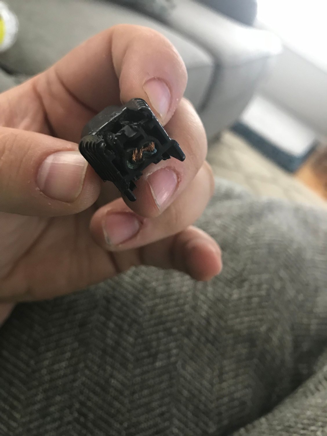

I have absolutely no clue about cars but ive got lots of common sense. My cars check engine light came on for emissions. I looked under the hood and found chewed wires, disconnecting two connectors. Ive done tons of googling but cannot figure out what parts they are or where to get them. I did figure out how to disconnect them though. Any links, or comments or even what parts they are or where to get them will really help, i cant afford to pay to fix it and im due for inspection by the end of the month.

Knowing the year, make, model and trim of the vehicle would help.

2015 honda civic hybrid-leather

That is the VTEC oil control solenoid valve. The top connector is for the oil pressure sensor on the unit.
