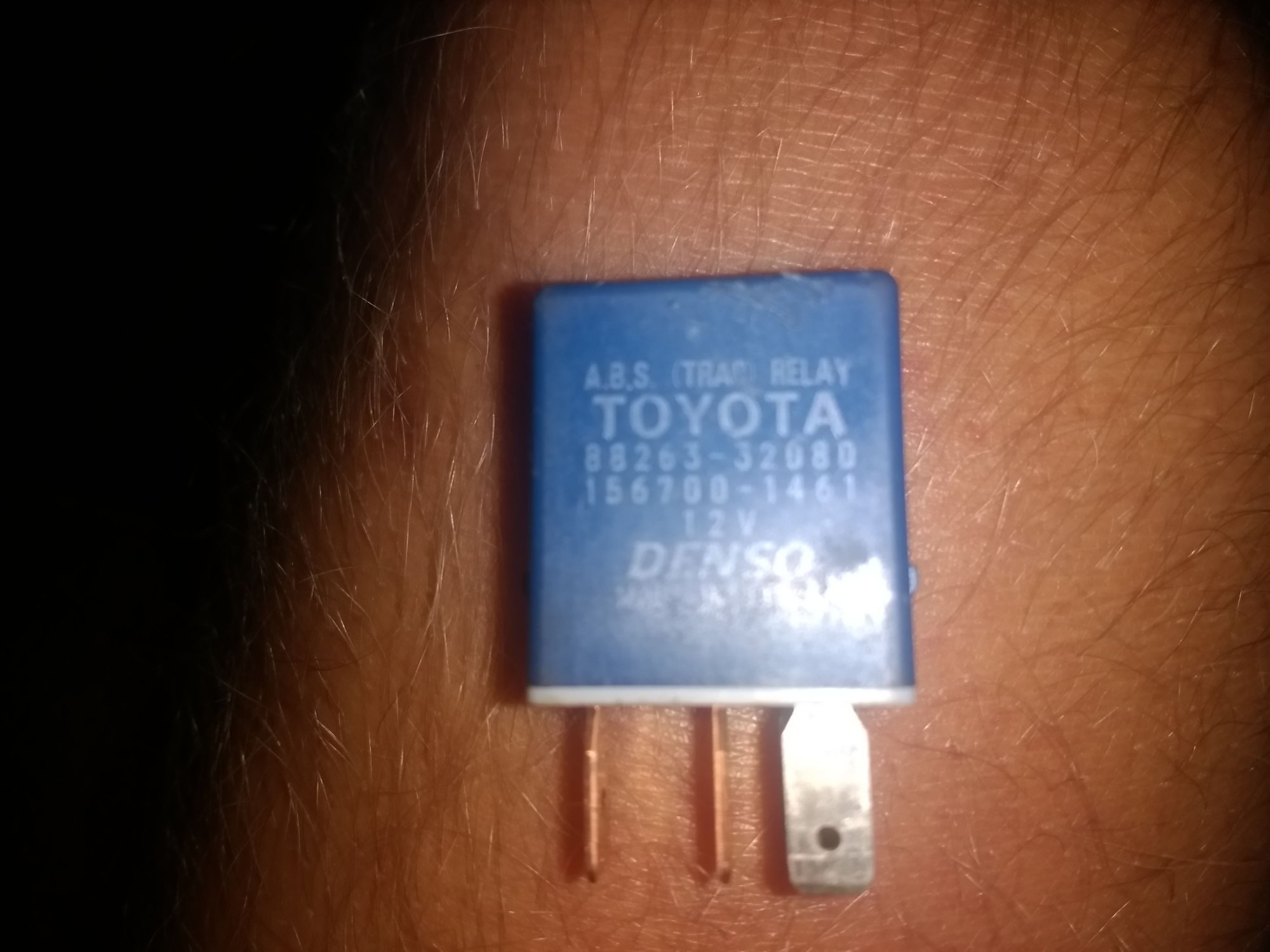

looked online and read the relay is a common fault and located it on my car (changing a fuse/relay is about my limit on cars) however mine pictured below says "toyota ABS" on it?
is it worth spending £5 for a new unbranded relay off ebay?

A relay is a relay is a relay. The important thing to note here is it says DENSO, which is the OEM supplier for a bunch of Honda parts. Does it still click when you engage the A/C unit? Can you grab a spare relay from an auto salvage yard for basically free?

yes it can run fine for a few minutes then it just blows out whatever the air is outside, i'll try a different relay, that's about my limit with cars, then see what happens
