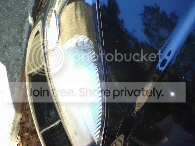

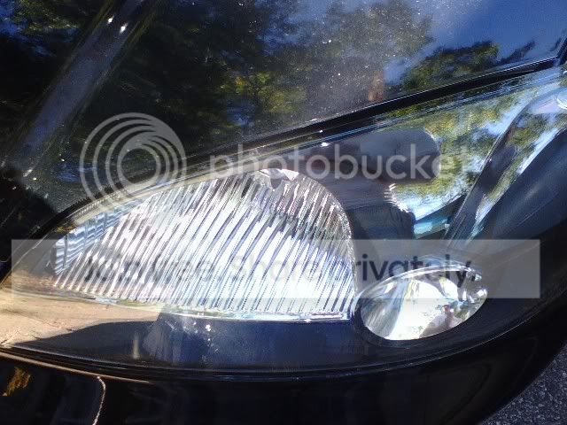

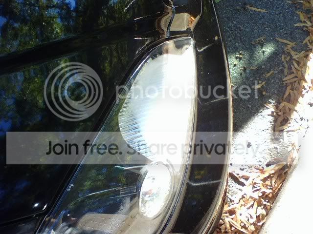

haha forgot to get pics ......its raining out now so ill get some pics later but basically there is moisture inside the headlight

other clear headlight
here are 2 pics......i dunno if you can see it
my friend w/ a WRX said he put his head light in his oven?? to break them open??
can i use a heat gun?
