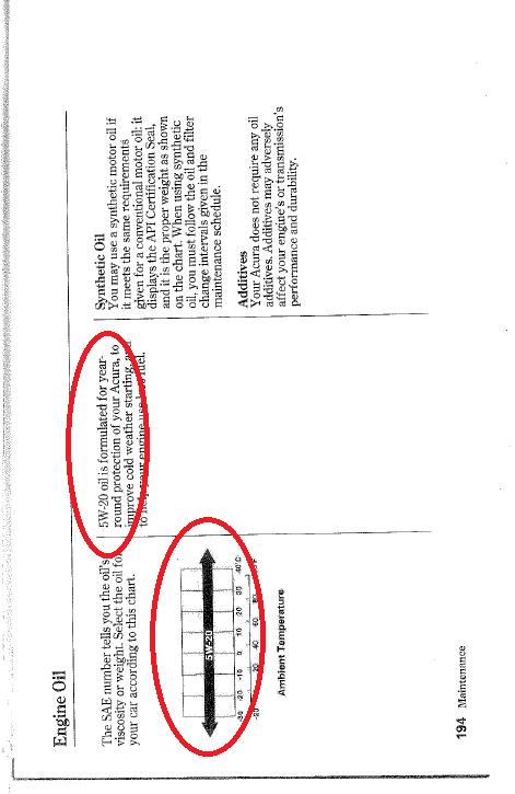

I have to say it, your mechanic is an idiot. There, with that out of the way, the correct oil for your car is 5W-20, conventional or synthetic (it matters not unless you extend your oil changes). Also, if you're going to go synthetic, go for 0W-20, it is a superior oil compared to 5W-20 in literally every metric.

The sooner you switch the better; no need to over think things.

My Owner's Manual states 5W-20 - see attached.
Got a shot of your Owner's Manual that says otherwise?
