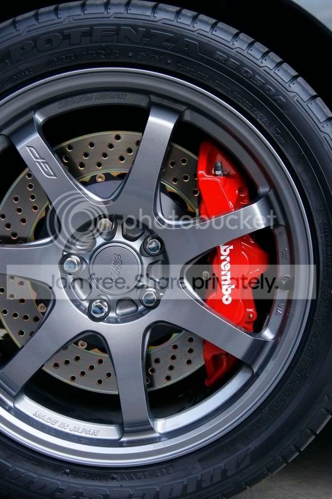

Did you use the Brembo parts from a modern TL-S 6-6? If you didn't what'd you do?
What size and offset wheels work with these?
Car looks good, by the way. Sort of looks like it's all about business.

Those ared not TL-S brembos...
Are those monoblock calipers?

Default OE caliper ?
Wheels : Mugen GP forged wheel 18x7.5 +48 5:114.3.....
Front brake : Disc 355x32 + 6 piston mono block caliper.
Rear brake : Disc 345x28 + 4 piston and Brembo hand brake caliper, both are same calipers use for ferrari F360 or Lambo Gallardo rear!
** All Parts are Brembo Gran turismo original parts.
*** They are not OE calipers !
**** Bells / brackes and hand brake cables are custom made by Toon motorsport.

Default Re: G8 Custom Brembo Brakes by Toon Motorsport. (Toonsport)
Excellent... then, thank you. was a kit or a custom assembly?

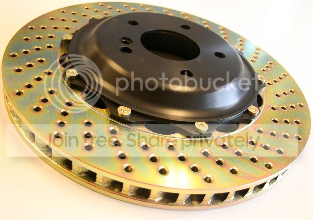

am i correct in saying that your rotors are put on reverse?
a number of cars I have seen with drilled rotors, have the hole pattern going the other way?

Default Re: (Ho!cord!V6spd)
thats sweep is just more agressive, it doesnt matter that much

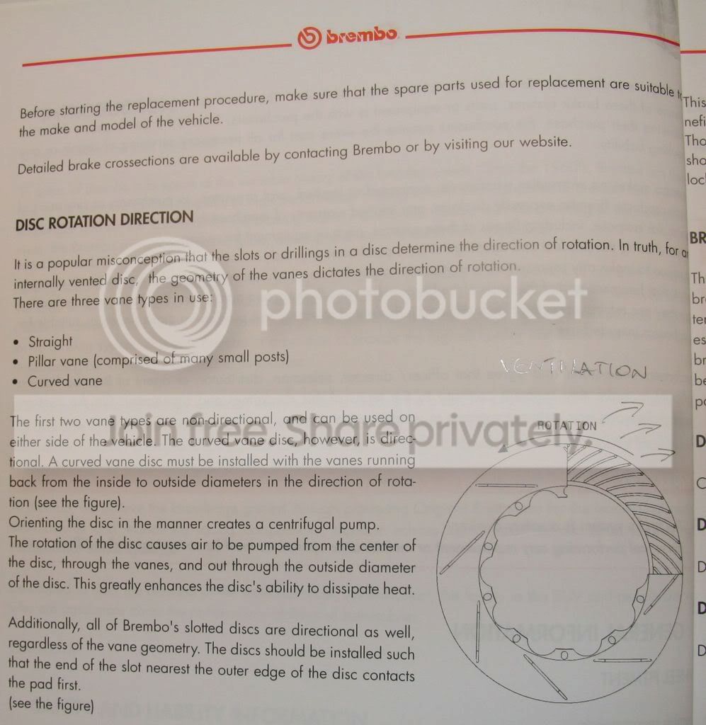

Default Re: (MSchu) Correct Brembo disc rotation direction !

Default Re: (MSchu) Correct Brembo disc rotation direction ! (Toonsport)
Sure... The disks can only go on one way anyway. I have seen sweeps in the other direction also... mainly slotted
