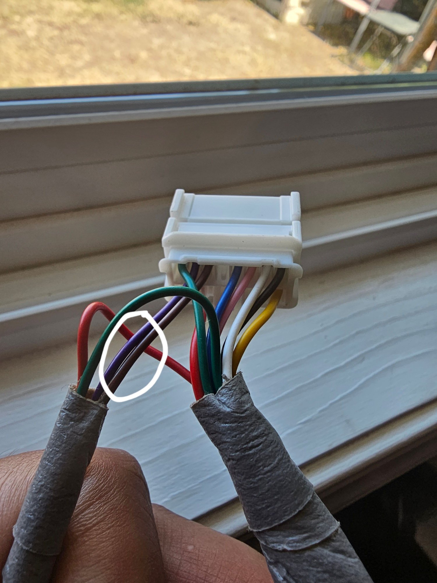

Hello, which two wires did you run please. Im looking to do this as well. I have a 2006 Accord 2.4 Auto. Im trying to figure if brown actually goes with brown, or both, or is one of these ground? Thanks!
