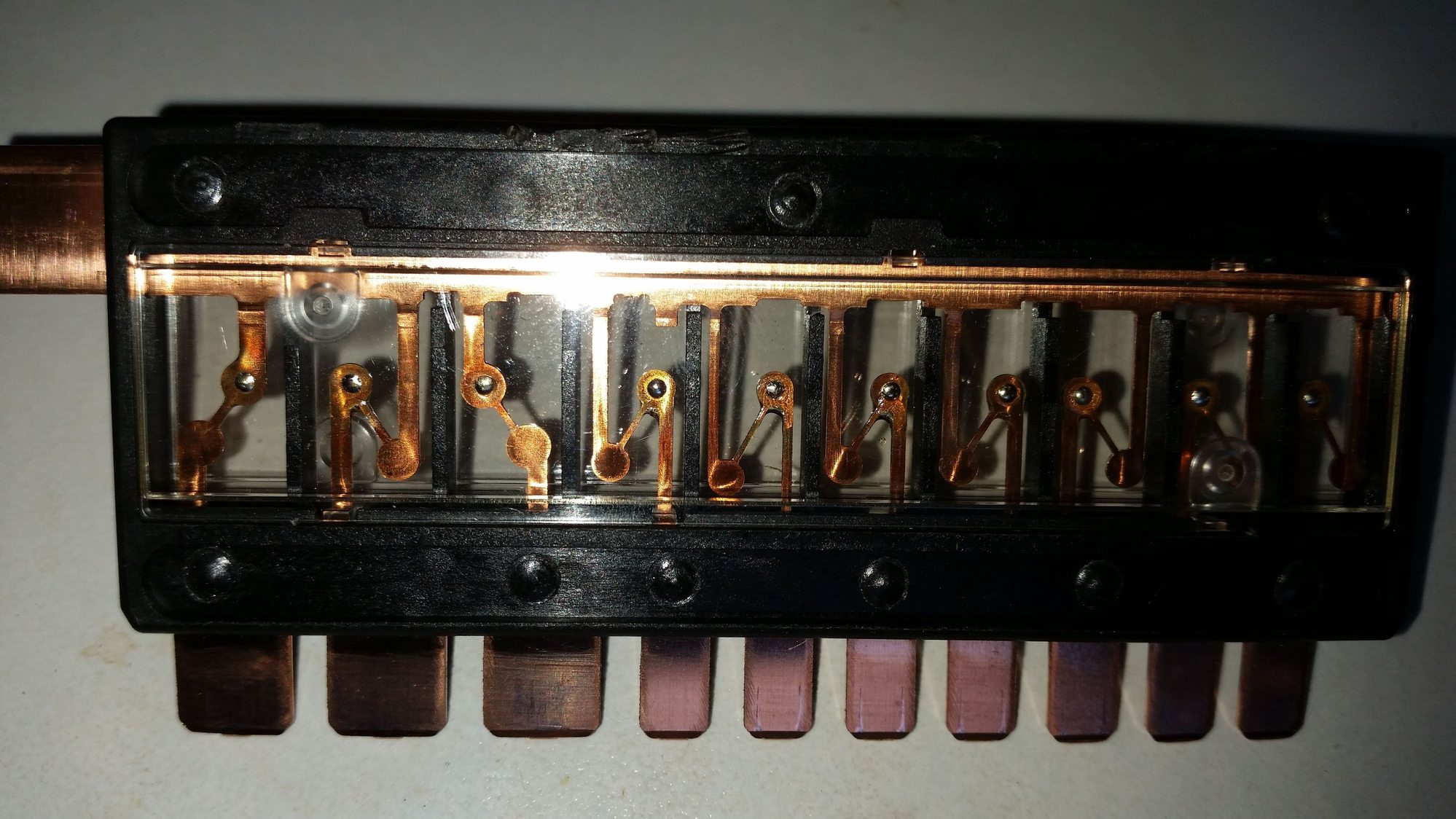

just to get some clarification, I tried checking it as you mentioned in the pic, I see #12 is a long slim bar, not sure how to open it, do I need to pull up or open with screw? I can see other fuse in the box it's just #12 is confusing. I attached a pic from my car fuse box. Let me know if you see anything unusual.
Old 07-30-2018, 09:02 PM
Audripulls's Avatar
Join Date: Jun 2018
Location: California
Posts: 95
Received 11 Likes on 10 Posts
Default Re: Accord 2013 4cyl - intermittent starting issue
Go ahead take the screw off and pull out the long black bar, After you pull it out you can see the numbers on top find 12-3 and check for any break, I'm pretty sure it's almost see through on the side so you can visually inspect it. Let me know what you see
Old 07-31-2018, 02:20 PM
r_u_live's Avatar
Join Date: Oct 2014
Posts: 17
Thanks! I had a look, it looks okay, (pics attached).

If the car clicks when you try to crank it over, I go no further & replace the starter. I've done at least 7 of them this year in the shop, very common.
I doubt its a alternator.
The fuse is good.
