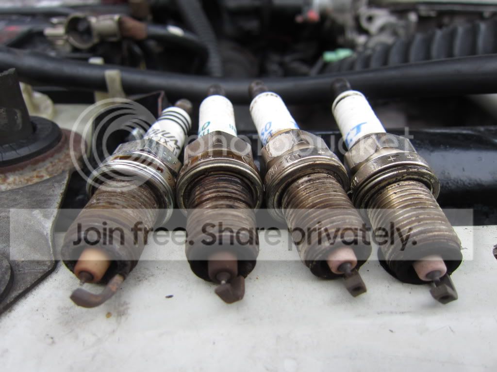

Pull the plugs, if there are any that are extremely clean or tinged with the same color as your coolant, be it green, orange, blue. Then you may have a leak from cylinder to coolant passage.
That should also show up in a cylinder compression test.

The plugs as far as I can tell look fine, but the car does tend to smoke white (water vapour maybe) at startup but stops smoking once it is up to temp...

What were the exact results of the compression test ? Are you losing coolant or not ? Is there any coolant at all in the oil ? Are you blowing white smoke out of the exhaust that doesn't dissipate after a couple feet ?
Can you pull the spark plugs and post detailed pictures of them ?

Re: Please help me to figure out why my accord is overheating...
I pulled the plugs today... The two Denso on the right are 5000km (3000miles) old
The other two to the left of it are barely 1000 miles old..
The 2nd from left has some oil on it so that could explain the misfiring when i first start.. Cleaned it up and the car started much better.
I also regapped all the plugs..
What can you people tell from the condition of the plugs and their respective ages?
