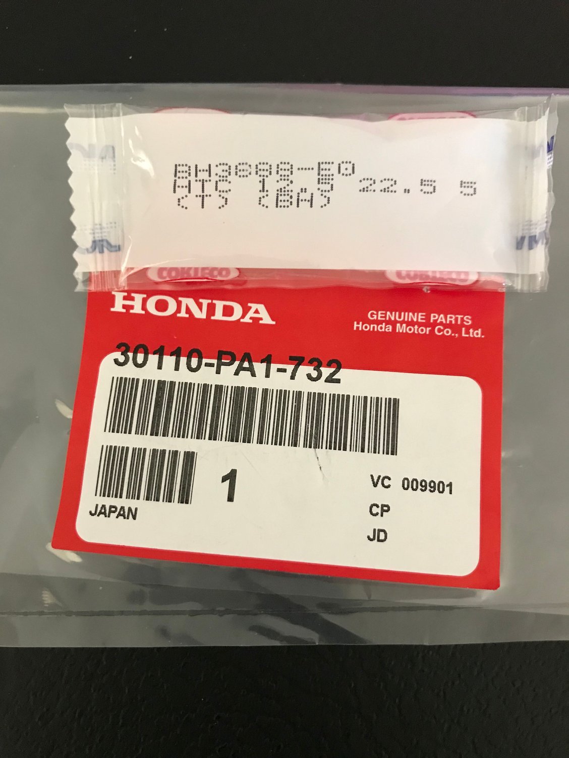

I believe these part numbers are for Accords too.
Top is inner seal-NOK/CORTECO
Bottom is O-ring dizzy seal
