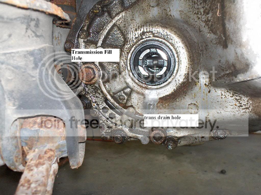

if you suspect wear, replace your MTF with GM syncromesh gear oil, and if its really bad, add some lucas engine treatment.
When you drain the oil, inspect the old fluid for brass shaving. If you see any, then your syncros are toast, and its time for a rebuild.
Heres a pic of where to drain and fill the fluid just in case you dont already know.
