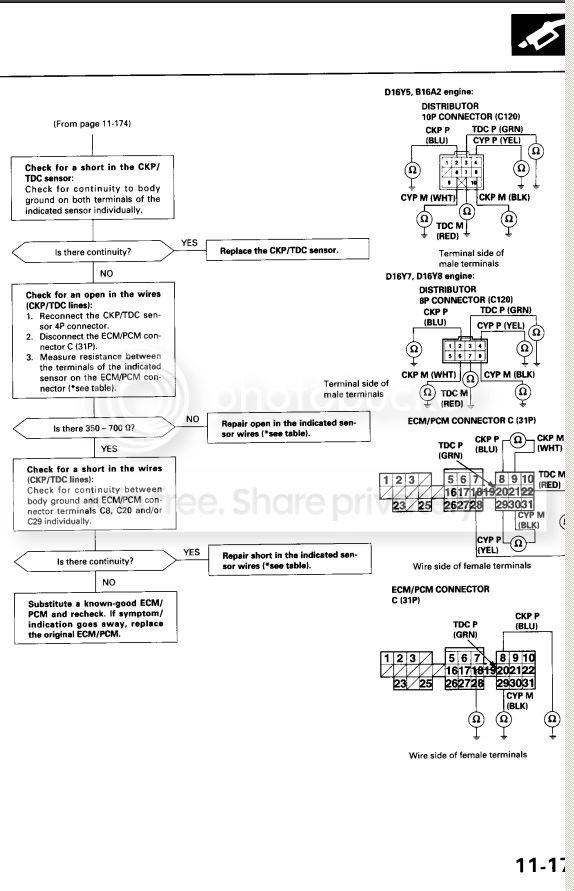

You only stated that the vehicle has a DTC stored for the TDC sensor CIRCUIT. Circuit being the key word there because the presence of the DTC doesn't automatically mean there is a problem with the sensor itself only that the circuit feedback isn't what the ECM wanted to see. This means there can be a wiring problem, a sensor problem, a problem with the sprocket which generates the signal, the ECM or just a bad connection somewhere. It pays to diagnose because cheap is expensive.
The catalyst DTC will not be set directly by a faulty oxygen sensor. If the engine runs poorly in one way or another damage to the catalyst can result but at that point you need to replace the cat AND repair the engine. Though, catalytic converters will lose efficiency over time naturally as they become coated with junk.
I would only let someone capable of diagnosing the DTCs perform the repair. And I don't mean a guy who pulls a code and says a sensor is bad...

Well the car has issues with the timing it seems and goes into a kinda limp mode and everything I have read says this is associated with the P1361 TDC intermittent interruption. I need answer on what I asked about about the location of the sensor and if the distributor needs to be replaced or if just the sensor can be replaced.

Well, unless you are going to try holding the shop accountable for the cat going bad because they said a faulty O2 sensor wouldn't damage the cat ( you'd have to prove the O2 sensor ruined the cat anyway ) it looks like you need to open your wallet and buy a cat.
You can replace the sensor by itself but it is much easier to replace the entire distributor instead.

Phootbag thanks for your replies. As far as the TDC Sensor I am still confused. On the 2000 Civic EX, is it in the distributor or is it under the timing belt cover? Or is the distributor itself under the timing belt cover? I am confused as to why I was told I needed to replace the entire distributor and that I can't just replace the sensor, when I can buy the sensor by itself online for about $40 ( 37500-P2F-A01 SENSOR ASSY., CRANKSHAFT (TEXAS INSTRUMENTS) A new distributor is $390, big difference!
1. So lets first deal with that question about replacing the distributor/vs just the Top Dead Centor Senor. One dealer told me that this part # I listed is not the TDC sensor, when 2 others and that online parts dealer (who is also a Honda Dealership) said it was.
2. Where is this sensor located? I was quote about between 1-2 hours the other day to replace the sensor. Another place like I said told me it would be 3.5 hours and that since it was like doing a timing belt job, I should just replace the timing belt and water pump now along with the sensor. So again a major discrepancy between what I am being told.
