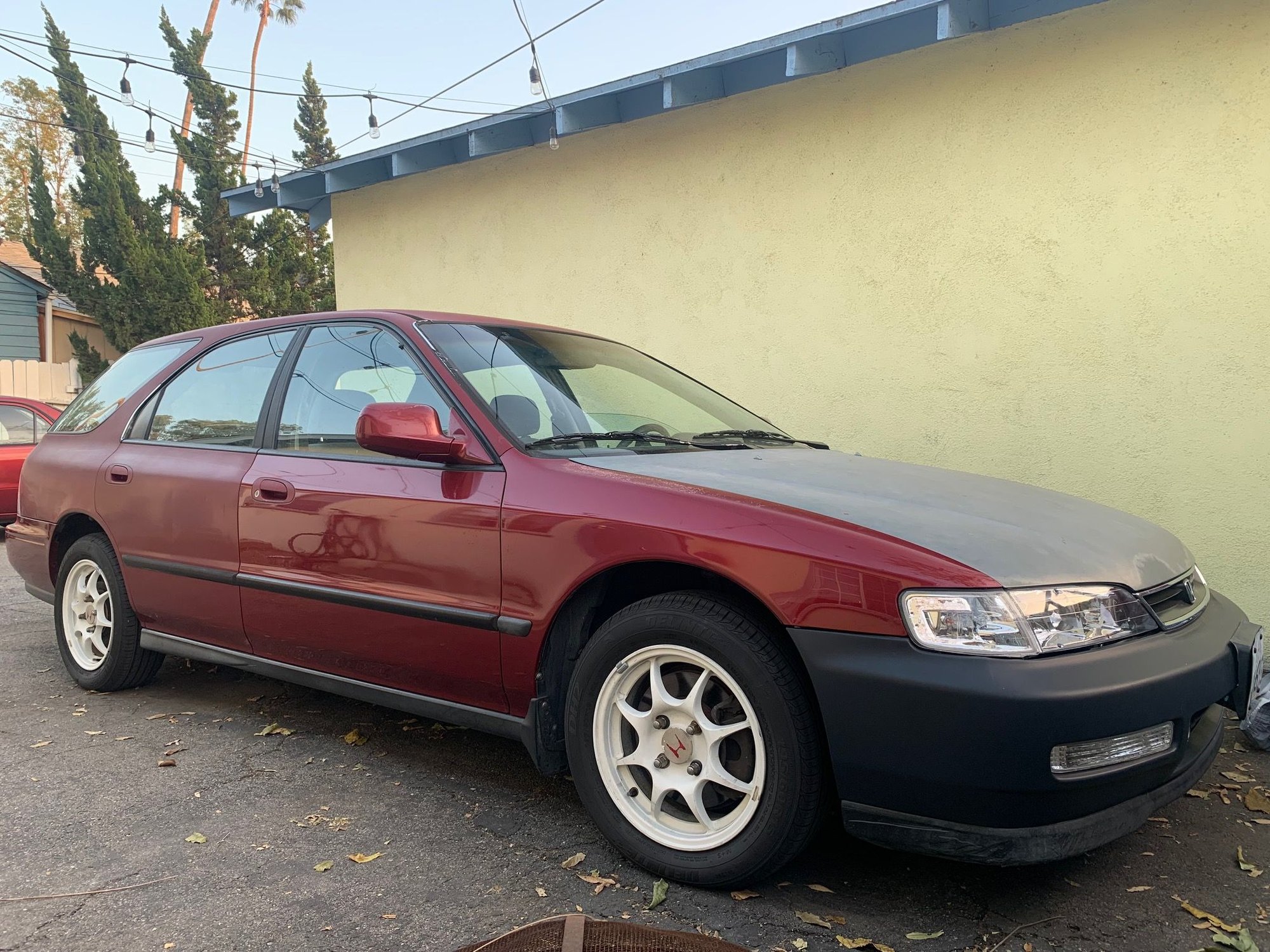

So big thanks to @TheHondaMahker for making me realize I should probably start a thread to keep a record of my build (FYI: it wont be updated often but it will be updated as money comes and goes). Ive done maintenance work and repairs on cars and bikes for years now but I never really did a "full build", so this is kind of my test for that. There's a lot I don't know and I want to use this platform for trial and error, and do everything possible from wrench to paint to refinishing the interior. That being said I am MORE than welcoming to any tips, tricks, resources, criticism, etc. I still have a few years till I can legally import my dream car (CL2 AWD Accord Wagon SiR) so I think this is the perfect project to keep me distracted till then
To start I purchased a 94 wagon from a family man who bought it from the original owner. It has 129K original miles on it (non V-TEC F series motor) and I literally have a full stack of paperwork from when it was first purchased until the day I acquired it. That being said it definitely saw use. It's in kind of rough shape, but seemed to have decent guts (and an even better price). As it stands right now the work Ive done already is replacing all the yellowed light housings with clears (which I somehow got lucky and was able to find the FULL clear taillights from a place in Europe), swapped the hood/front bumper/grille for the 96-97 style as it was dented up anyway (but I kept the 94 lip), added some non-US OEM Stanley fog lights, and some DC2 rims. Currently I'm collecting parts to do a complete front suspension rebuild and just waiting on my Ground Control shocks to show up. I'm also going to do a rotor over hub conversion at the same time, I wasn't able to find any new hubs so I pulled some from an Acura CL in a yard and I'm ordering new studs (I have spacers on to fit the rims and not sure if Ill need longer studs or not after the conversion). After that I have plans to do the rear suspension, redo all the doors, try and get my hands on some power folding mirrors, and get a mid wing deck spoiler.
Here's the current look:
Re: 1994 Accord Wagon Build

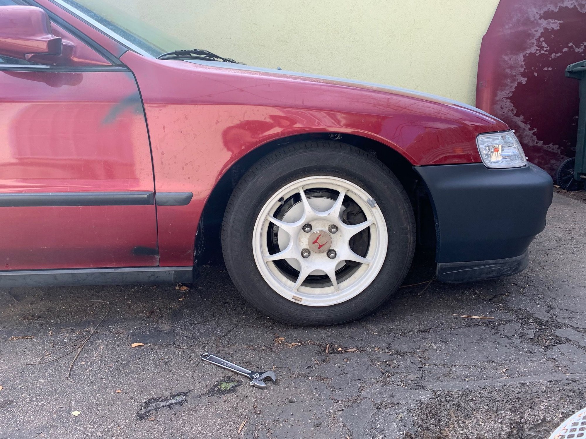

Someone backed into my original "frost" headlights, so I ended up replacing them with the clears from japan. It was an amazing difference in terms of the quality of the optics, much much better beam focus etc on the clears.
Re those rims, they are worth a lot, so please put some sort of wheel locking nut or something to secure it.
For suspension, i found the prothane polyurethane bushing kit really firmed things up for me, tightened up everything, and fitment was better than the energy suspension equivalent

Looks good my friend, those all around clears really make it stick out. I tried to find some junkyard find CL hubs myself but to no avail. So I bought two news ones (hub and bearing together) from eBay, and they have taken me on a couple longer vacations with no issue. I gave a review in them, here is the link https://www.ebay.com/itm/Front-Wheel...-127632-2357-0
I do not know for sure if these will fit the wagon, but they fit my sedan just fine. I also do not know of any auto parts store (I.E Autozone, Oreily’s) that sells them. So I was kind of forced to buy these.
Looking good, can’t wait to see it progress…

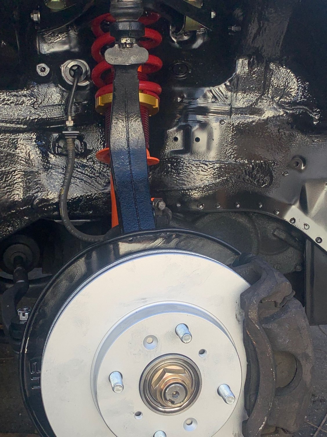

So I had a whole post with a Waggy update but my Internet is a PoS (Spectrum) and erased it. So I'm just gonna do a quick one instead. Got the suspension / psint started, did the RoH conversion, but im having an issue with the upper ball joint spinning! if anyone has any tips they would be much appreciated! heres where im at as of today:
Oh I feel that shitty internet issue…
Do you mean the nut holding it onto the knuckle? Or the ball joint itself not coming out? I cannot tell in the picture if the boot is seated properly, did you install it yourself or did it come with the upper control arm?
Onto to a more polished note, the body underbelly and frame looks mint!

@TheHondaMahker Thank you!
It actually was a seating issue with the upper ball joint! It came with the upper control arm. It wasnt seating into the knuckle, I had tried jacking it up but it still wouldn't seat, literally had to wrap a ratchet strap around the upper and lower and cinch it to lock it down haha.
It's all set now, just need to get a new torque wrench that hits 180 ft lbs for the axle nut. Then ima paint the wheels (Matte Gold I'm thinkin) and keep going with the Matte Black as I put the panels back on. I'm going to paint the calipers too eventually but I'm gonna wait until I do a whole flush and rebuild of the brake system!

Glad I could help! I asked about the pre-installed ball joints because I’ve have some that fail if they came pre-installed…

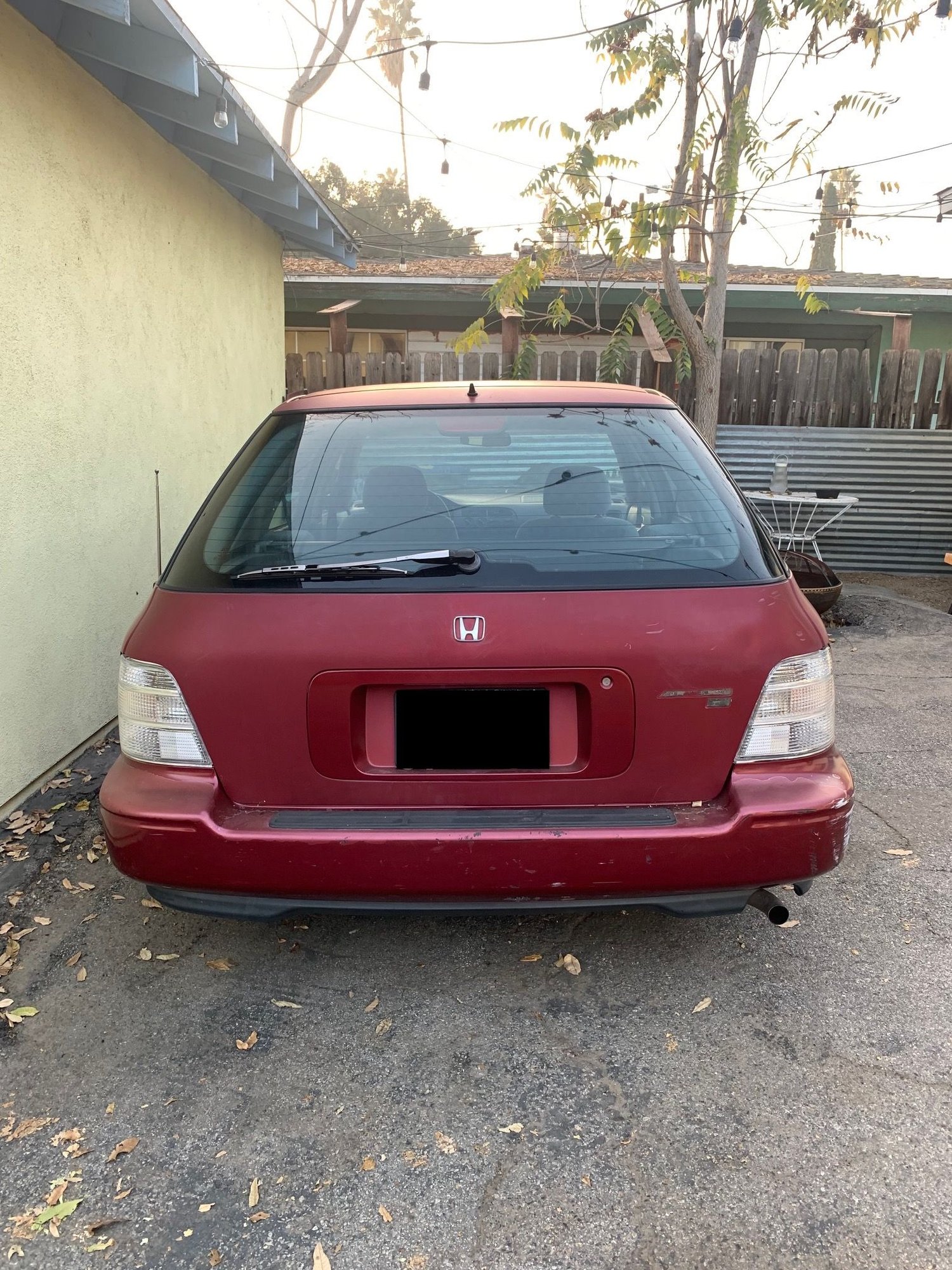

I'm glad y'all like the paint! As it turns out though I hate painting/body work haha. I assumed this already but had to confirm, so moving forward I'm gonna scrap the plans for that and focus on the mechanics/tweaks/maintenance stuff. That being said I finally got the front end back together and I'm pretty stoked about it! I got the jack stuck because I didn't realize how low it would drop the front lmao:
Adding a photo of the rear for comparison:
I just got new window regulators for the front driver/passenger doors I'm going to try and get installed today (driver side busted so i figured ill replace both), then I'm going to turn my focus to the rear suspension and get a whole alignment eventually once thats done. Also have to fix the classic "stuck antenna" which every old car has haha
It's moving along though and I'm definitely learning which to me is what this project is about
