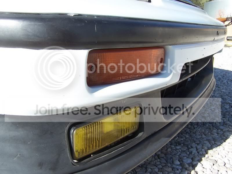

Default Re: (NAallTheWAY)
I could never get my dern black trim pieces around the cutouts to fit well either. I had the original ones as well. Try finding new ones of those
So I tried door guards like that and it did ok...

tiny dabs or gorilla glue in the corners? patience? i dunno i have never messed with those.

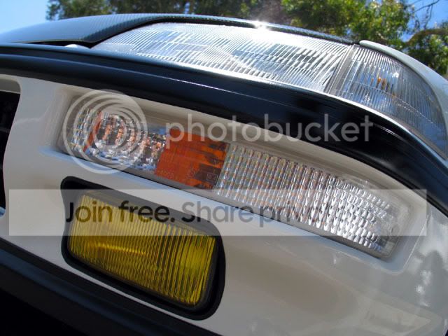

Default Re: (b16_madman)
<TABLE WIDTH="90%" CELLSPACING=0 CELLPADDING=0 ALIGN=CENTER><TR><TD>Quote, originally posted by b16_madman &raquo;</TD></TR><TR><TD CLASS="quote">
I used black silicone to hold them in place. Also, I couldnt find a part number for the rubber garnish/seal in the JDM Honda parts book. A guy i know bought some brand new USDM clear square halogens/fogs complete with brackets, harness, garnish etc from the dealer. Everything had a part number except the garnish. Its very strange. The same guy that bought the USDM ones used to live in Japan and is going to contact one of his friends there to get him to actually walk into the dealer and ask about them . I'll update here as i get info.
Here's a shot of mine from a while back. I really hate this pic b/c of the hood misalignment but it shows the halogen/fog fitment. I can rest easy though cuz i fixed the hood loooong ago LOL.

another alternative maybe take some lenght of vacuum tubing and a razor blade, slit the tube down the lenght, then use it to cover the edge of the cut out, give it a decent look, for cheep

<TABLE WIDTH="90%" CELLSPACING=0 CELLPADDING=0 ALIGN=CENTER><TR><TD>Quote, originally posted by DEIVIONCRX &raquo;</TD></TR><TR><TD CLASS="quote">another alternative maybe take some lenght of vacuum tubing and a razor blade, slit the tube down the lenght, then use it to cover the edge of the cut out, give it a decent look, for cheep</TD></TR></TABLE>
I was actaully thinking about doing the same thing but haven't gotten around to it...everytime i find the fogs they never come with the surrounding rubber
rubber saves lives by the way
