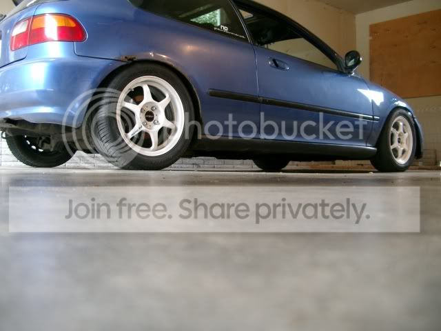

couple new pics squad, what do you think of the new shoes? their a buddies but we threw them on while were dropping the tranny for a new exedy clutch
also how much trouble is it to drop the trans out of the bottom of the car?

It's very easy man, yank both axles, bust the rear mount (leave it attached to the crossmember) and then pop off the pass side mount (leaving one tranny bolt in that's easy to get to).
Take a pry bar and separate the tranny from the block enough to move it by hand.
Lean over the fender, grab it, pull back and let it down.
When you take the pass mount off, the tranny and motor are going to lean down a LOT, it's ok, it won't hurt anything, just makes it easier to set the tranny on the ground.
Nice wheels as well, I am looking for a set in black myself.

are those 15s? I began my quest of getting p1's a while ago but they are 16s for my ek... in black

if i were u i wouldn't worry too much about new shoes, or dropping the tranny. u got a rust infestation going on in ur car. better get that taken care of..

i was waiting for the rust comment, no one said anything about the fender tho lol, yea the rust is a problem i will prolly fix it this winter if i can find a 1/4 panel replacement.
the wheels are 15's but the funny thing is my 16's weighed about the same give or take 2-3lbs

yea that fender is pretty beat, i noticed it yet didnt feel like telling anyone to fix anything with my passanger side fender being in the condition it is
