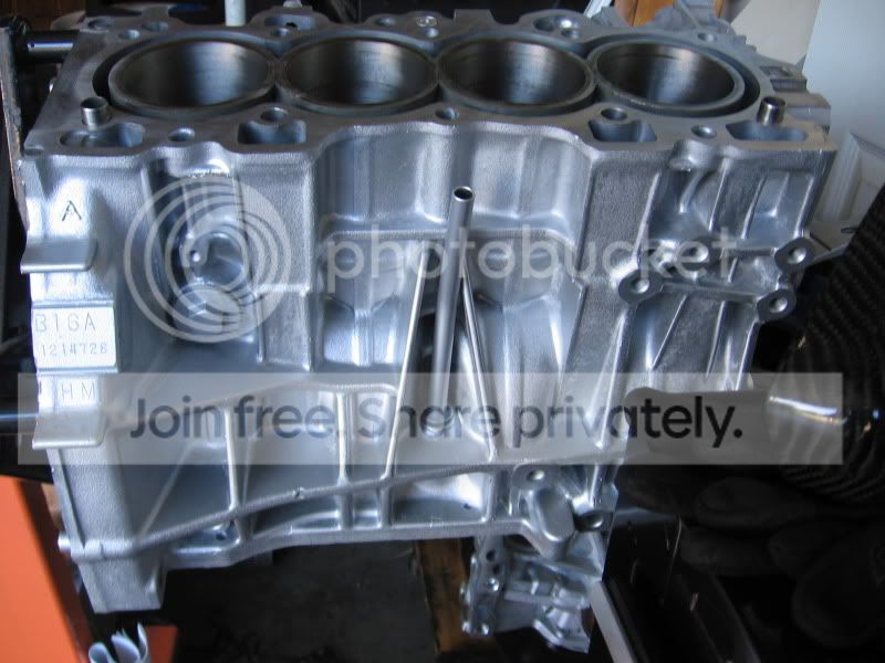

NO WAGON #1 IS NOT DEAD! hahaha just been laggin on post's cuz... well i'm lazy. Heres some updates.

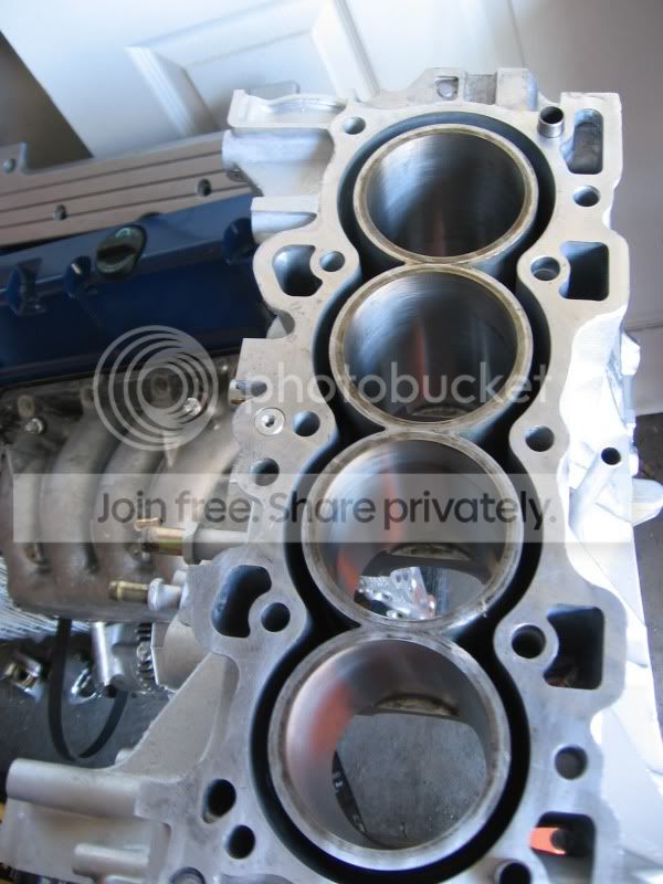

My new B16 block, just resurfaced and Honed it.
and going in...

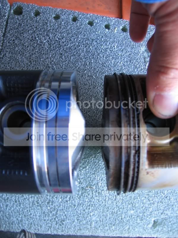

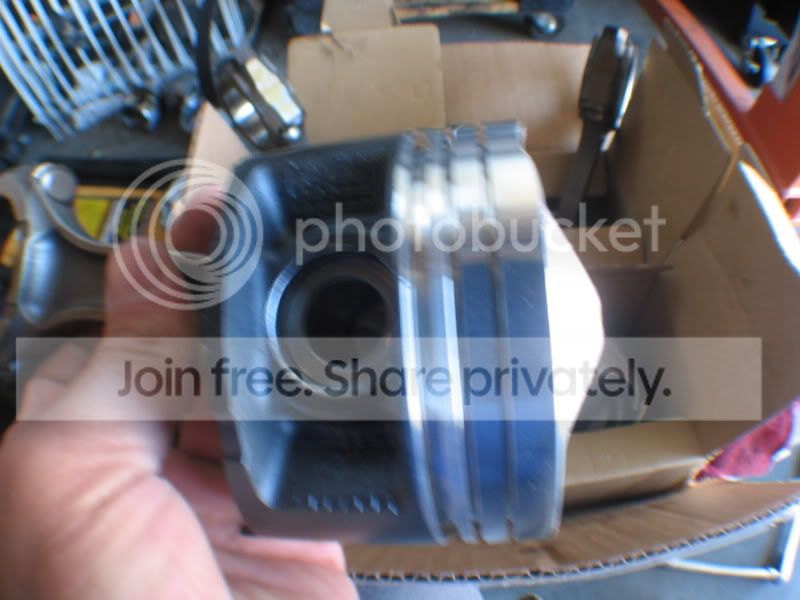

My CTR's :D
11.1 FTW!!!! haha
(on the left is the CTR, right is stock B16A3 piston)

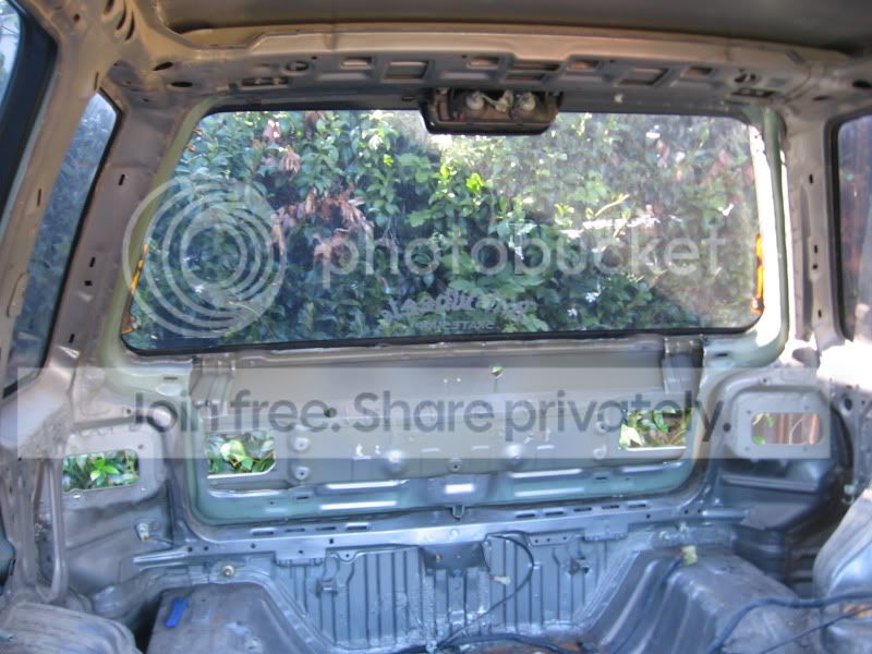

I removed all rear brackets from my car. Rear seats and spare tire bracket.
I shaved the skeleton for my rear hatch. Not sure if i like it anymore tho, might get a new one and just leave it oem.

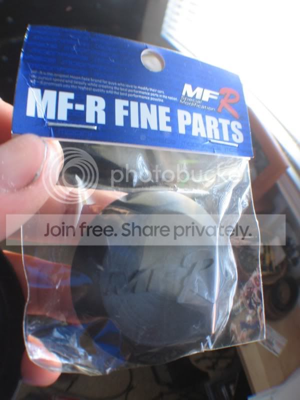

And i got this pretty hard to find MFR rear wiper plug from a good friend in San Francisco. Thanks ryan!

hard to tell from the pics but that hone job don't look right i don't see a cross hatch and if thats not there you will have problems

haha Theres cross hatches for the oil, not my first time. But thanks for lookin out.
