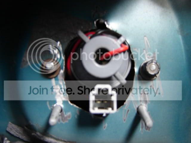

I apologize for not wanting to go throught the 30 pages you guys have here..just got a quick question.
I'm going to be installing a jdm rear fog lamp on a del sol. How do I get the light to stay after I plasma cut my hole (in the garnish)? Are there brackets I can buy? Any help would be great.

you have to cut into the sheetmetal underneath the panel. i have a picture of the inside of the trunk to give you an idea of how its on there lmk if you want to see it
edit: aw expletive it heres the pic (this is what happens when you dont have a plamsa cutter

isn't there mounting screws on the back of the light itself? i remember ray ray had them when i was doing his for him. you have to drill the holes for the mounting points and screws.

What bulb/harness are you using for your rear fog? I dont have anything...Just the lens itself.

and im using the bulb that came w/ it. (thanks rick!) i still need to wire it up though..

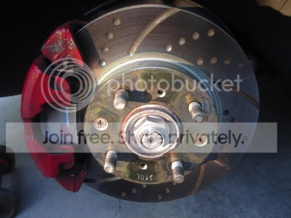

i hope thats the rear cause those are going the wrong direction if its the fronts.

there should be 2 screws built in the light, just like the pic show by afro sheen

now THIS is a can of worms.
Powerslot recommends one way, Baer recommends the other..... there is no right way to put them on
jimmy: were you using new pads and new blank rotors? were they bedded correctly? there are too many factors to say exactly how or why something stops better

it depends on the inside vanes. your right in every rotor is made different. if the inside vanes are straight then it doesn't matter which side they go. if the inside vanes are curved.... then they are directional.
