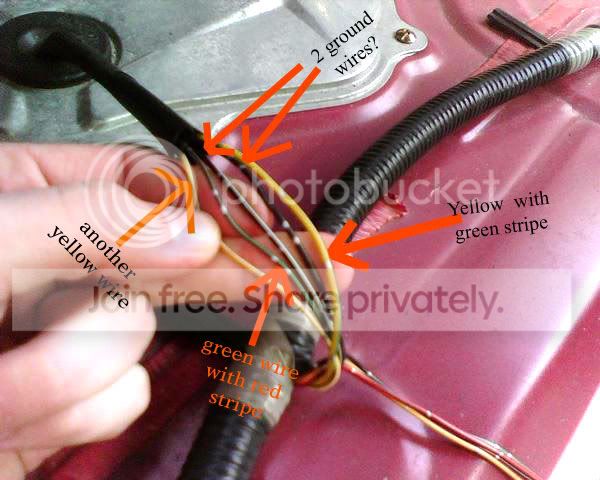

So I'm working on a new little project. Trying to make a fuel pump cut off switch. What I'm trying to figure out is what wire I need to cut into to put the switch in. There are 2 ground black wires, 2 yellow wires one with a green stripe, and one green wire. I don't want to make a mistake. If anyone could give me some advice I'd appreciate it. Thanks so much.
Heres the guide im going off of.
https://honda-tech.com/zerothread?id=1297327
If you scroll down you'll see the picture of the fuel pump wires, and where he's spliced them in. I have a 96 del sol, and obviously its different.
So this is what im working with.
Which do I cut?!

Default Re: (love of the sol)
edit: on second thought its been a while.. don't listen to me
But I believe the fuel pump+ is one of the yellow wires. It runs from the main relay to the fuel pump connector.. just pop that metal cover off and take a look at the color of wires that run to the fuel pump..
(it is the white connector in the picture)

Posts: 8,217
for the fuel pump kill switch, the way to test is to get a test light (pointy screw driver lookin thing w/ light in it ) poke a wire, turn the key to acc. and there should be 1 that has constant power (dont tap into that one) then another that will light up, and shut off after a few seconds (after the fuel pump primes) thats the one you tap into for the kill switch.. honestly i forget which color wire it is, but thats how you can tell

Default Re: (RNPoo7)
the wire for the fuel pump is yellow with green stripe your welcome
