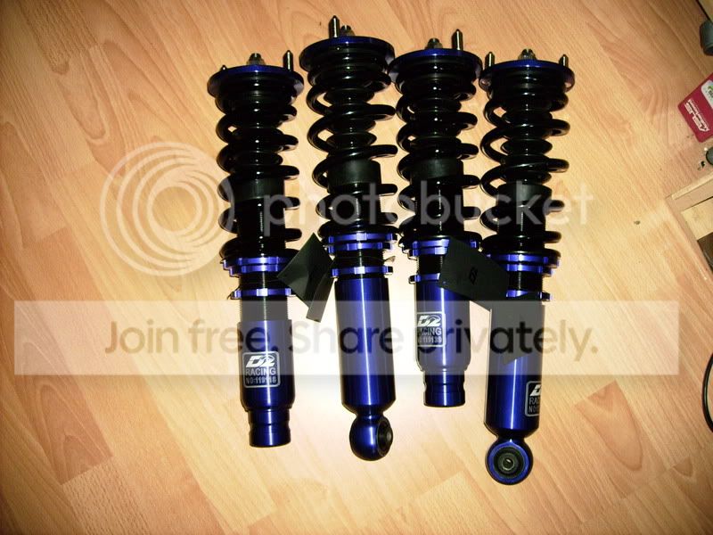

<TABLE WIDTH="90%" CELLSPACING=0 CELLPADDING=0 ALIGN=CENTER><TR><TD>Quote, originally posted by king-of-the-hill &raquo;</TD></TR><TR><TD CLASS="quote">guys i need your wisdom!!!!
a friend offered me a D2 set for an EG but i dont know if it'll fit my DA6... it seems to have the same mounting points but i wonder if they WORK good on a DA6 (it's almost 200kg heavier than an EG)
this is the set
thanks!</TD></TR></TABLE>
I've never seen Blue D2s before...mine are purple
this is the set
The rears are different, between the DA and eg's where it bolts to the lower control arm, on the DA it's a fork and the control arm going up into it, I think the type R rear lower control arms will work

<TABLE WIDTH="90%" CELLSPACING=0 CELLPADDING=0 ALIGN=CENTER><TR><TD>Quote, originally posted by italionstallion888 &raquo;</TD></TR><TR><TD CLASS="quote">
The rears are different, between the DA and eg's where it bolts to the lower control arm, on the DA it's a fork and the control arm going up into it, I think the type R rear lower control arms will work </TD></TR></TABLE>
That's not true. If those coilovers were made for a USDM car there would be no difference between EG and DA mounting. Both USDM EGs and DAs use fork type LCAs. Since this guy has a JDM DA6, the rear suspension will bolt right up to his car with stock rear LCAs. JDM DAs have box style control arm just like the ITR does.

If i'm not mistaken, the biggest "problem" with using DC/EG coilovers is the lengths. They're longer in the front and shorter in the rear than the DA's so you have to slam the crap outta the front and raise the rear so it's not all uneven. Just swaping the stock DC suspension makes the car look like a '64 Impala with hydraulics ridin with the front all the way up

lol yeah i knew about that length problem... if it fits like ****, i just sell the D2 and get some other coilovers... it's always worth a try
mine's got box style rear lca's, so that won't be a problem
the photo of the D2 set was taken by camphone and IRL it IS purple

<TABLE WIDTH="90%" CELLSPACING=0 CELLPADDING=0 ALIGN=CENTER><TR><TD>Quote, originally posted by ChaseIntegra &raquo;</TD></TR><TR><TD CLASS="quote">If i'm not mistaken, the biggest "problem" with using DC/EG coilovers is the lengths. They're longer in the front and shorter in the rear than the DA's so you have to slam the crap outta the front and raise the rear so it's not all uneven. Just swaping the stock DC suspension makes the car look like a '64 Impala with hydraulics ridin with the front all the way up </TD></TR></TABLE>
actually that isnt true eighter i ran both stock dc suspension and aftermarket full dc coilovers in my da and the dc stock shocks in the front were actually shorter and had more travel

<TABLE WIDTH="90%" CELLSPACING=0 CELLPADDING=0 ALIGN=CENTER><TR><TD>Quote, originally posted by DATZ WEAKSAUCE &raquo;</TD></TR><TR><TD CLASS="quote">
actually that isnt true eighter i ran both stock dc suspension and aftermarket full dc coilovers in my da and the dc stock shocks in the front were actually shorter and had more travel </TD></TR></TABLE>
im running DC2-R front koni Yellow SP3's with ek forks, and i have no problems. i believe they were the same length if not a tad shorter.
