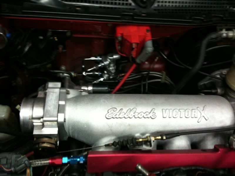

This build just seems to wanna throw me a curve ball every single day I pop the hood or open the door lol ... Here's my dilemma.. I have a victor x manifold, skunk2 70mm tb and a golden eagle fuel rail and now the type r throttle cable bracket doesn't fit ... I see some say use an ls bracket but then some say they still have the same prob and I think that'll be the same In my case ... If anyone has any suggestions or pics id really appreciate it ... Also I have another issue with the rad hitting my full race downpipe so if anyone has had the same issue and would like to share a solution and pics it would also be appreciated

Pics help, just use whatever will work really. I dont even know what bracket i have on my gsr
here is mine, victor with STR 70mm TB , i think mine is on with 1 bolt. been holding fine for 12k miles

All the newer Edelbrock's come with a stamped throttle bracket enclosed...I'm sure if you contact them you can purchase it seperately.
If I remember, an LS flipped upside down with one of the holes elongated works just fine.

I ordered a type r bracket, and had to install it upside down so the wire wouldn't rub
on the runner. Also using a str 70mm tb.

on my car i just used a gsr throttle body + cable. routing the cable the other way ended up rubbing on the oil feed line for my ls/vtec.
