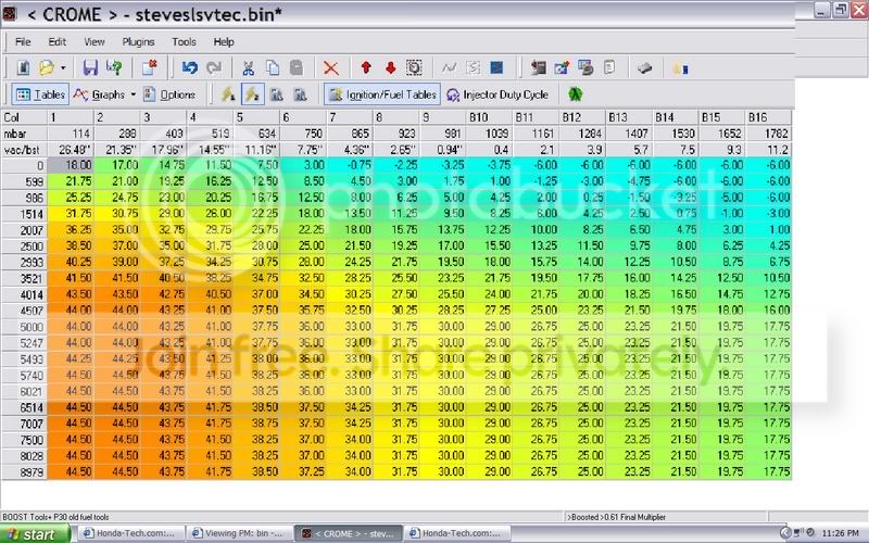

Basicaly im just a basic stock ls/vtec. t3/t4 57 trim running 10-11 psi of boost. Where should i be at for timing on crome.

try take'n out 1 degree for every lbs

well this is just the vtec map.

thats looks fine to me. you could run more if you wanted.

How much total timing should i be at at 11psi? Its gonna be a month or so before i can get to the dyno.

about 17.75 with 1 degree taken out.

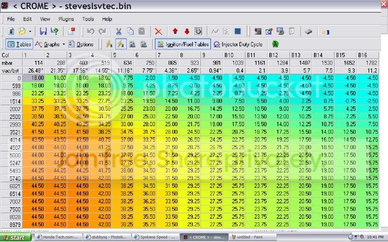

So something like this?

the first map you have posted has a little to much timing taken out.....but it's very safe.
you need to have it on a dyno to be certain though.

<TABLE WIDTH="90%" CELLSPACING=0 CELLPADDING=0 ALIGN=CENTER><TR><TD>Quote, originally posted by a1320honda &raquo;</TD></TR><TR><TD CLASS="quote">well this is just the vtec map. </TD></TR></TABLE>
wrong, i see boost tables,
OP, looks really conservative, is this a base map or your new perm. tune?

The first one was just my basemap.
