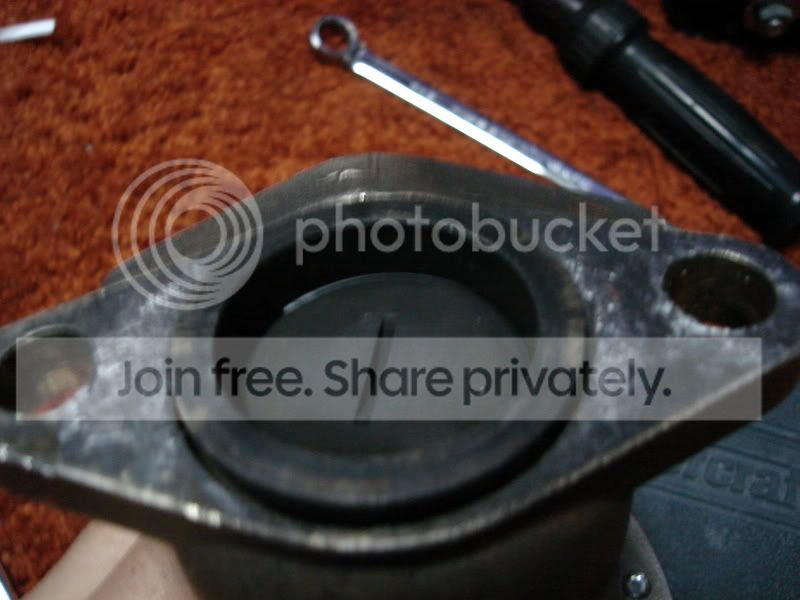

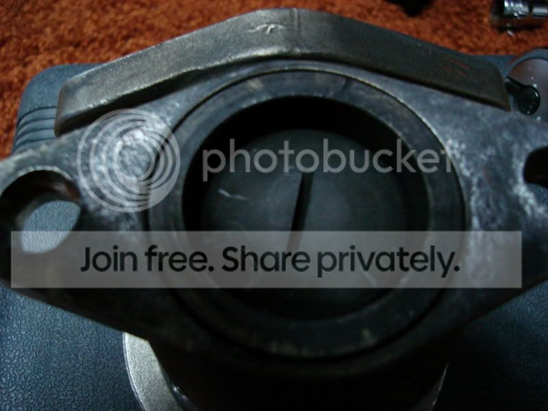

hey guys, need some help on this wastegate situation. i've e-mailed turbonetics but no luck. first off i have a turbonetics evolution WG, the problem is at the flange, where the valve seat is. basically there is this ring that won't stay in, therefore making the flange uneven like so:
now with this ring sticking out, the valve isn't seated properley, there's a space inbetween the ring and the seat:

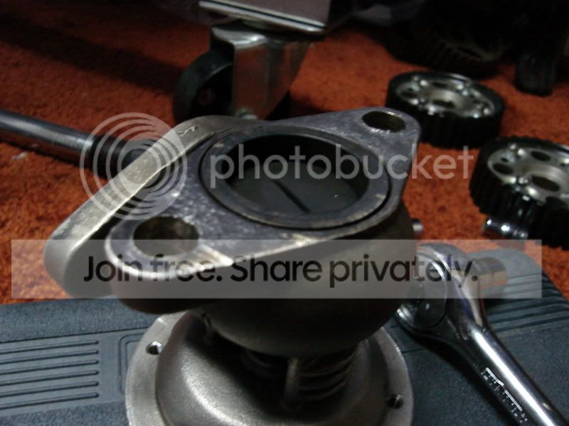

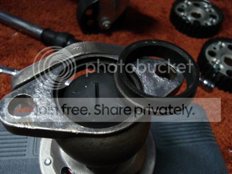

with a little bit of wiggeling, the ring can come right out:
when i pull apart the WG, and take the spring out so that there's no tension, the seat seals nicely against that ring, and the flange is flush:

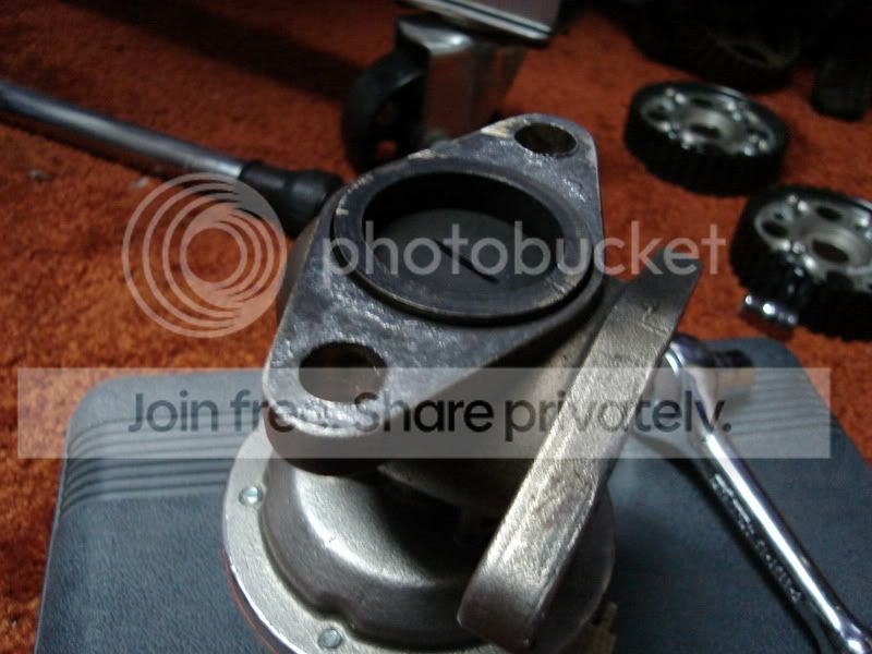

however when i put the spring back in, and tighten the cap down, it pops out again :
i'm just wondering how i can get this thing to stay put in there, so that the flange will be flush so i can mount it.

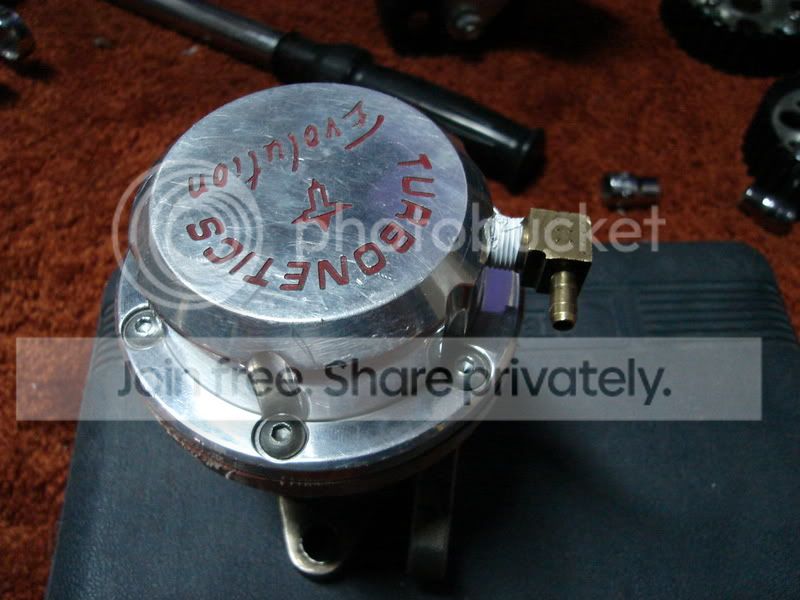

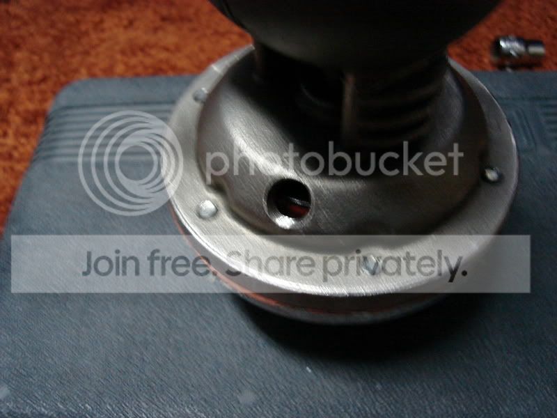

also, i saw this threaded port on it:
i'm not sure what it's for? there's allready a vaccume fitting on it in the cover:

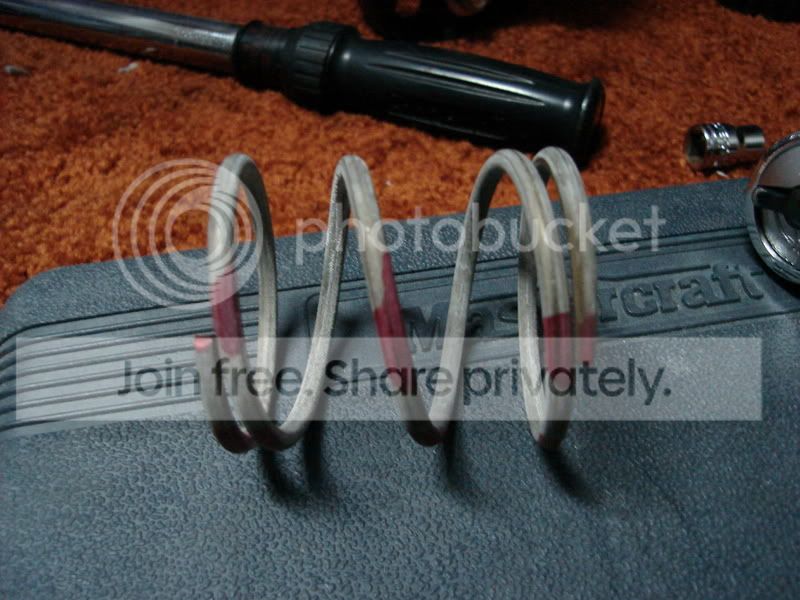

and lastly, does anyone know what psi spring this is?

Just bolt the wastegate on and the fire-ring will press the valve up. Its normal

put the ring in where it sticks up the least, and tighten it evenly. what you are looking at is the wastegate valve seat, or fire ring as we call it.
your issue is 100% normal. even the tials do it.

they are all correct
this is what seals the gates piston on the manifold, without it you cant hardly build any boost and it makes a hell of an exhaust leak
as long and you tighten it down evenly when you put it on, it will seal

As said, the valve is supposed to be popped up a bit, when you tighten the wastegate down, it presses in the valve for a good seal.
The second port on the wastegate is for an electronic boost controller. When you have a manual boost controller, it only goes to one port, when you have an electronic boost controller, there is also a solenoid, that goes to the other port on the wastegate to force it to stay shut until it hits the set boost level you set in the boost controller.

And the bottom threaded port is the one you want to use to control boost. You need to pick up a fitting for it and attach your vaccum source there.
And like already stated, you don't need that top port unless you are running an EBC.

Red spring = 9psi, thats the factory spring.

ok.. thats a 9psi spring, that ring is a fire ring (just bolt down the wg that ring will press in) and the vac ports, the one with fitting, apply vac line to it (from intake mani, not turbo vacume).. That is the line that will read boost, other opening, just leave it, its used to run a EBC.

other way around. the one with the fitting will stay open and the bottom one will get boost from the intake manifold. your way will make 428psi.
If you want to just run the spring pressure you will just hook up a line from the port with no fitting in it now to the intake manifold. It will probably make a little less than 9 though.
