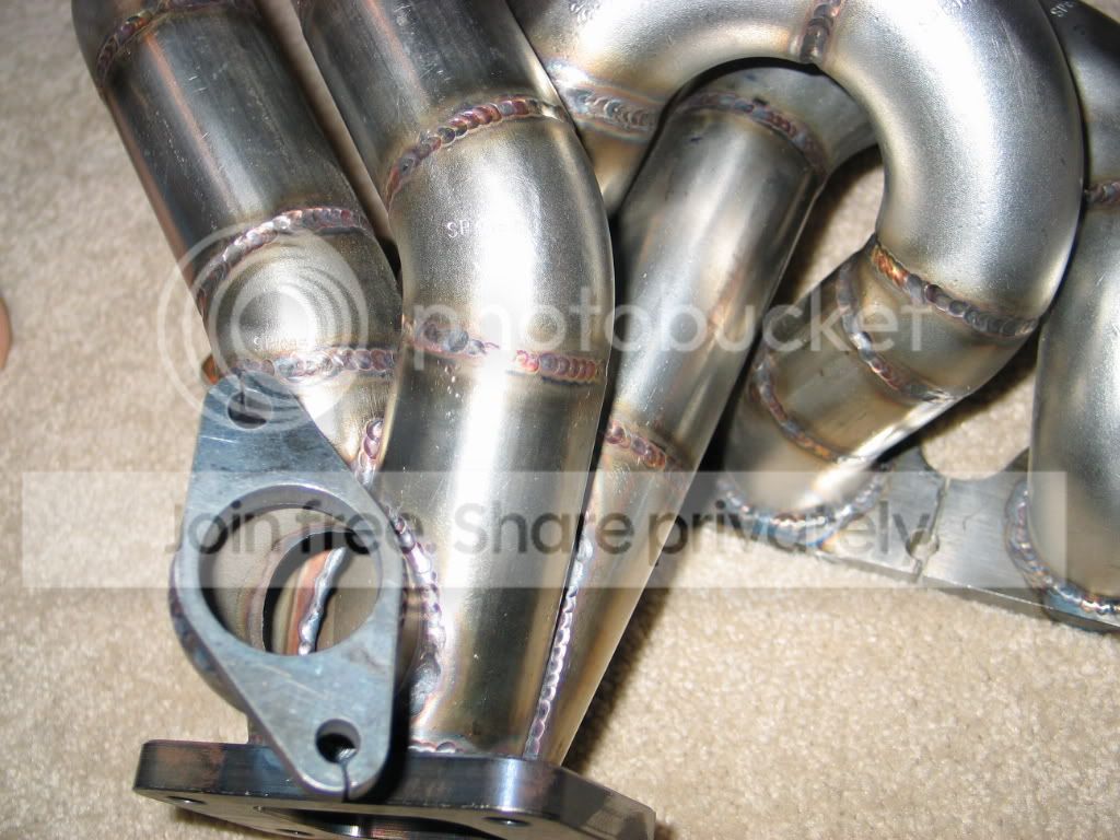

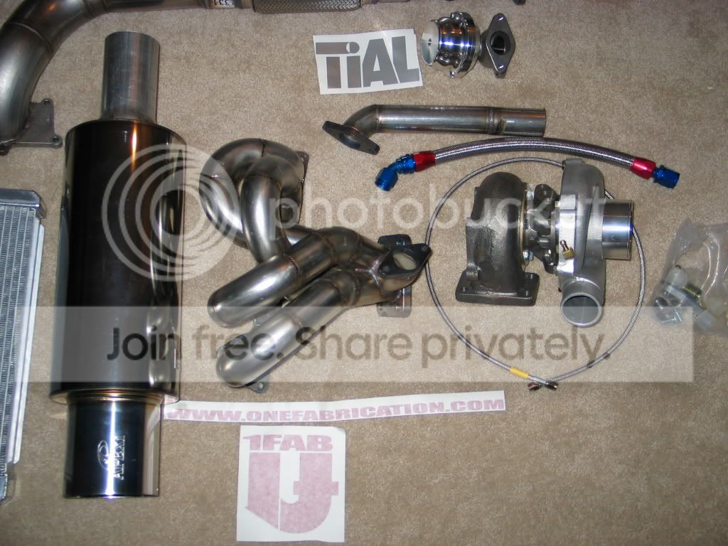

here's some old pictures
here's a pretty recent pic

What I meant was that you can still get the biggest gate and get creep weirder things have happened and as far as you wg placement it looks really good. I meant to say that if you buy the biggest gate first you eliminate the gate as the problem but if you go with the 44 and still get creep then you are back where you started and sorry for not making myself clear before.I think you shouldnt buy the ebay one because if you have a problem with it then you are out the cash spent on it and the money you will have to spend on the new one and nice setup by the way
