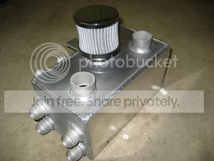

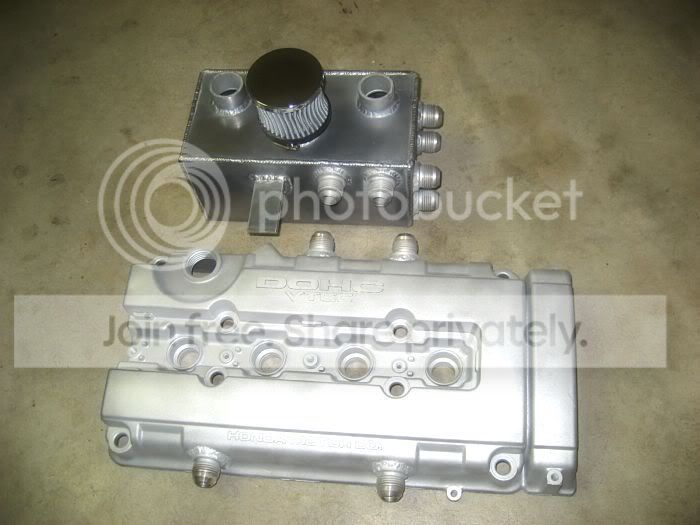

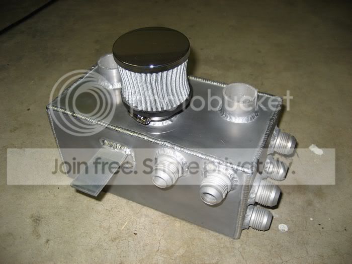

Or you can make something like this!
Had my lil bro weld and make me a catch...not bad for a first timer on aluminum...
Im to lazy to polish this stuff myself...mite get it all chromed powdered soon..
I give credit to Tony1 on the design idea!
Old Jun 3, 2007 | 09:47 AM
the.hamburglar's Avatar
Posts: 2,210
From: Canada
Default Re: valve cover venting? (iBrandon)
What are the holes at the top of the catch for? Are they for extra ventilation? Are you putting two more filters on top?
Old Jun 3, 2007 | 10:22 AM
iBrandon's Avatar
Posts: 1,240
From: Oklahoma City, OK, usa
Default Re: valve cover venting? (the.hamburglar)
yes two more filters goes on top
