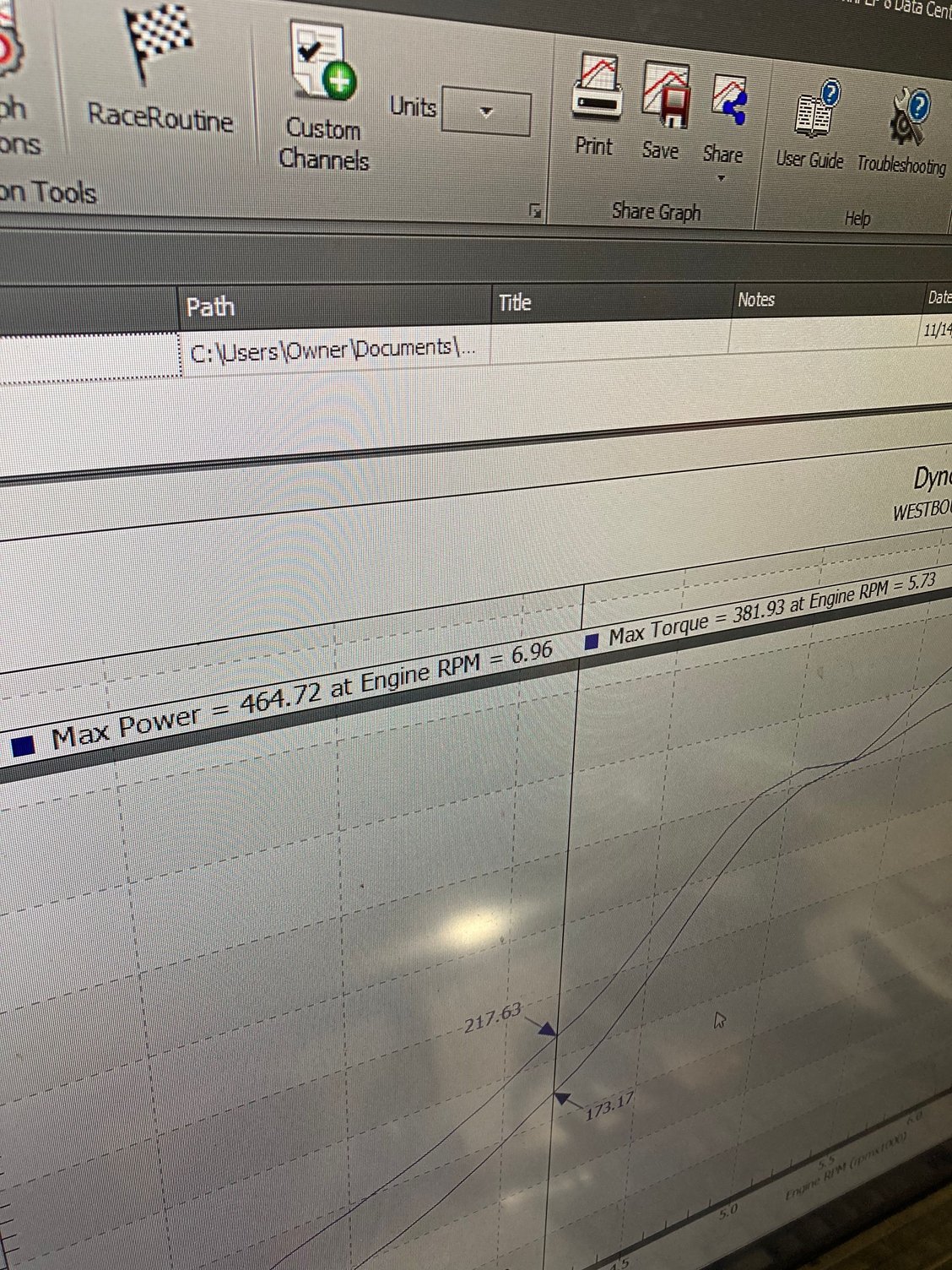

So I made 464whp and 380tq on e85
with a Garrett gt3076r on my 81mm sleeved gsr spool is amazing I love the way it feels but it’s time for more power I just don’t know what turbo to upgrade to that’ll put me in the 600s but not be so laggy it’s a street car with a few ifo events as they come just looking for some input maybe see what numbers have been made with other turbos I don’t have a picture of the whole graph but I’ll post what I have thanks

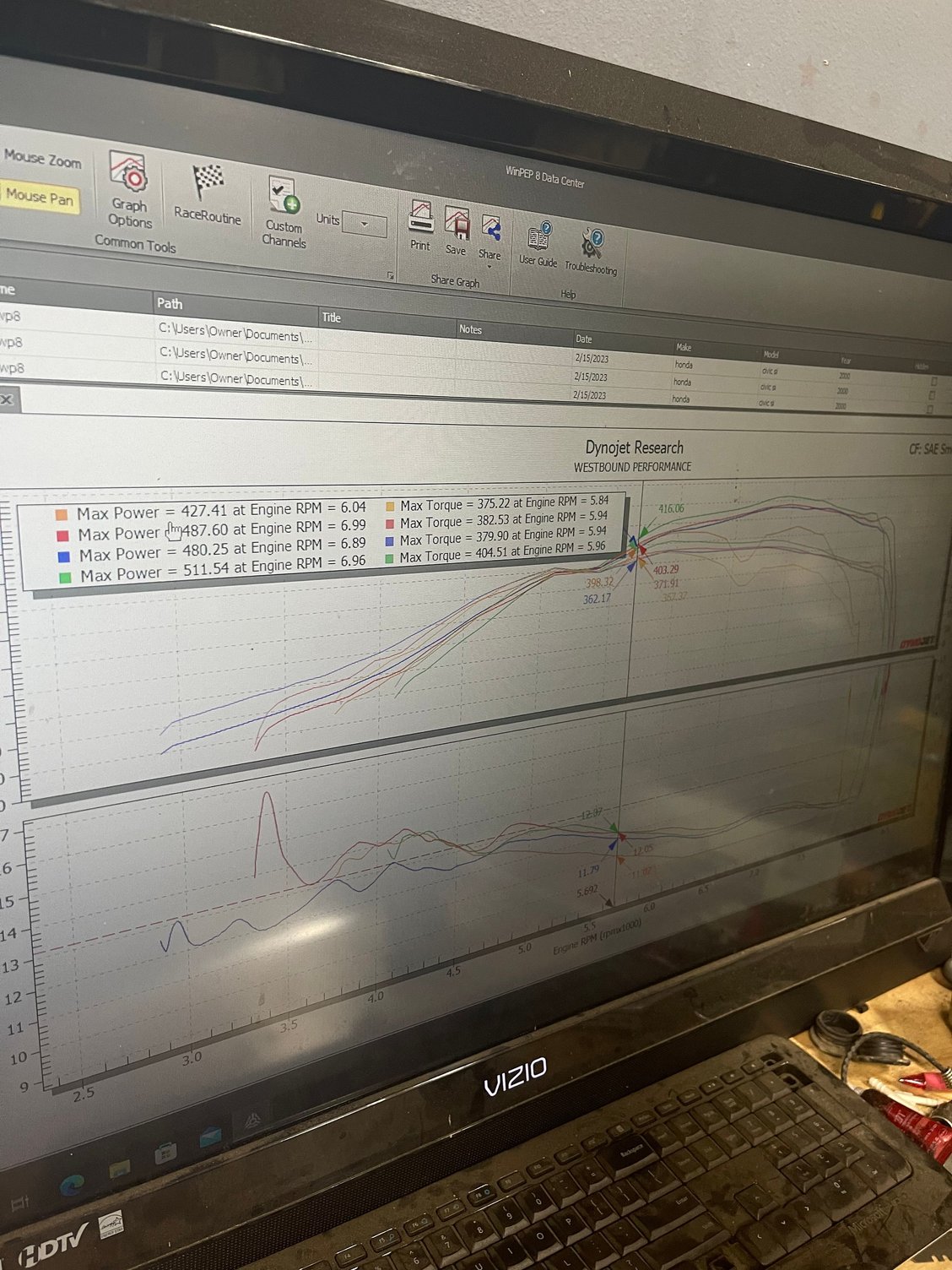

New update I upgraded my fuel pump hanger to a dual pump setup just to get the an fittings and ran a -10 and a -8 return boosted the hp up to 511whp and 404tq I’ll post the numbers after I finish this post still wanting more out of it tho wondering if I should go with a gt35r or gt40r trying to get into the 650whp range but not sacrifice too much spool as it’s a street car

Nice work.
Also count me as another vote for 3576.

Originally Posted by Chance EG
Nice work.
Thanks..! I appreciate it do any of u happen to have any dyno graphs with a gt35r..?
I'd go for the GTX3567R or Predator for 650whp. A gen2 gtx3071R will not make 650whp.
