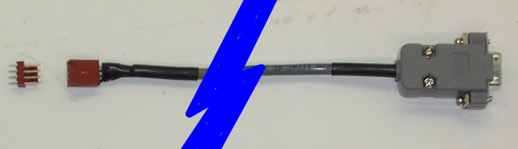

<TABLE WIDTH="90%" CELLSPACING=0 CELLPADDING=0 ALIGN=CENTER><TR><TD>Quote, originally posted by Black R &raquo;</TD></TR><TR><TD CLASS="quote">doh!
I'm thinking of trying the http://www.superdroidrobots.com/rs232.htm cable...
but I have no idea which one to buy... type 1? 5v?
I guess you can use the 4" long cable and have the header of the plug screwed into the ecu case for a clean look.....
Modified by Black R at 2:28 PM 3/17/2005</TD></TR></TABLE>
Yes, you want the Type 1, 5V superdroids cable, but dont get the 4", get the 72" one. Believe me, you'll want the longer cable. With only 4" of cable your laptop is going to be sitting in your passenger footwell right on top of the ECU. And just like you said, that little header gets soldered into your ECU on CN2 and the Superdroids cable plugs right into it.
header is on the left:
