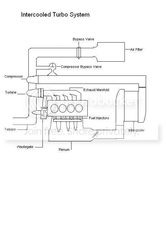

im new to the forced induction scene i was wodering how to set up my turbo
i have a t3 turbo that is going on a b16 (pictures would help)

What kinf of manifold? What down pipe? What intercooler piping ect ect?

i just need 2 know how to run all the lines etc.

Courtesy of Maximum Boost

Vacuum lines - all to a central source off the manifold. Don't tee off tiny lines like the FPR or you'll have mystery issues later.
Charge pipes - think about it.
Oil lines - again, think about it.
You need to understand how the turbo system works before you really should be installing one. Once you understand, you'll be able to answer 9/10ths of any questions you may have in the next few months. Turbos aren't like blind dates. They're like winning a date with a super model. You learn everything you can about her before the time comes, because once you blow it, its a long time before you can try it again.

id say , just buy a complete kit from like inline pro, greddy,drag, full-race, s-fab, or any other named turbo kit thats been tested and is good quality it will save you alot of headache, and just have some one else install it/tune it.

<TABLE WIDTH="90%" CELLSPACING=0 CELLPADDING=0 ALIGN=CENTER><TR><TD>Quote, originally posted by KillerAccord &raquo;</TD></TR><TR><TD CLASS="quote">
Courtesy of Maximum Boost</TD></TR></TABLE>
wrong... the bov goes in the pressurized piping, ie between the compressor and the throttle body. before the turbo it wont do ****
